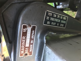

ID:	24152Here are some photos of the motor.

    https://www.ebay.com/itm/82645M-Merc...edirect=mobile I found it by looking up your serial # and doing a parts search. Double check tthe # and fitting but i believe it is what you need

    Thanks I'll give it a shot.

    It arrived today, fits great. Now for the tank ad line, are they special?
