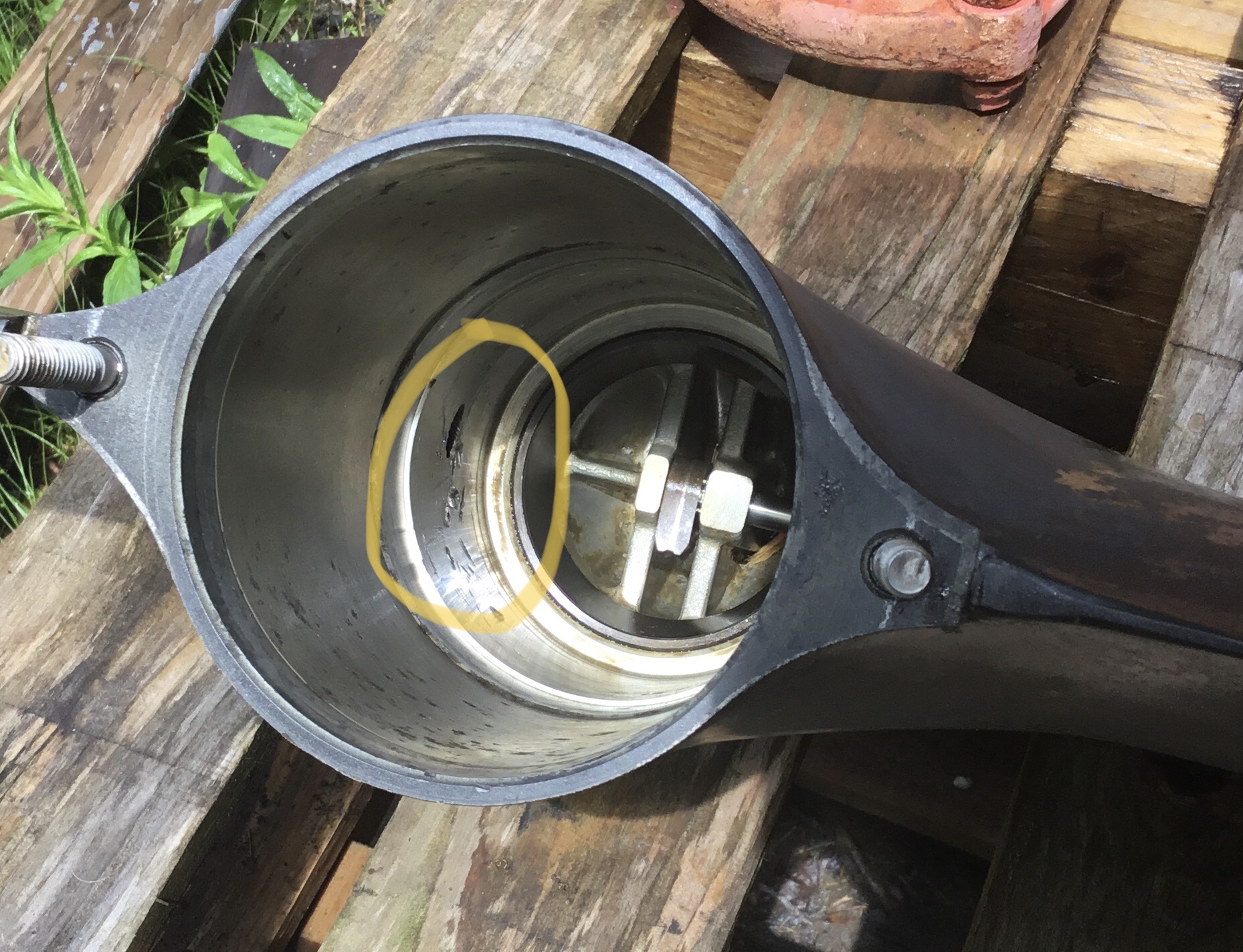

The dog clutch went on my lower end. The outside of the case looks good. The inside has some damage in the area of the drain plug. (See pic) I think it won’t effect anything but I’m looking for a second opinion. I have another complete unit that has outside damage but all inside gears are ok, so I’m looking at taking these parts and installing them into my original case. 6E604DBC-18E5-4E59-A8D3-13F274B299B7.jpeg
If it didn't pke a hole through the case?? then it should be ok.
You better check and see if you need to re-shim when changing gears??

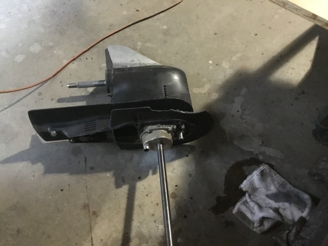

Instead of taking the parts from a working lower end with a broken fin into the case that had a broken up dog clutch would it be better to use this lower end (see pic) that has broken section on the side fin. I’m new at this and maybe fin isn’t the correct term but you’ll see the picture. AFF67BC8-0B56-412A-B320-846E176DC762.jpeg
