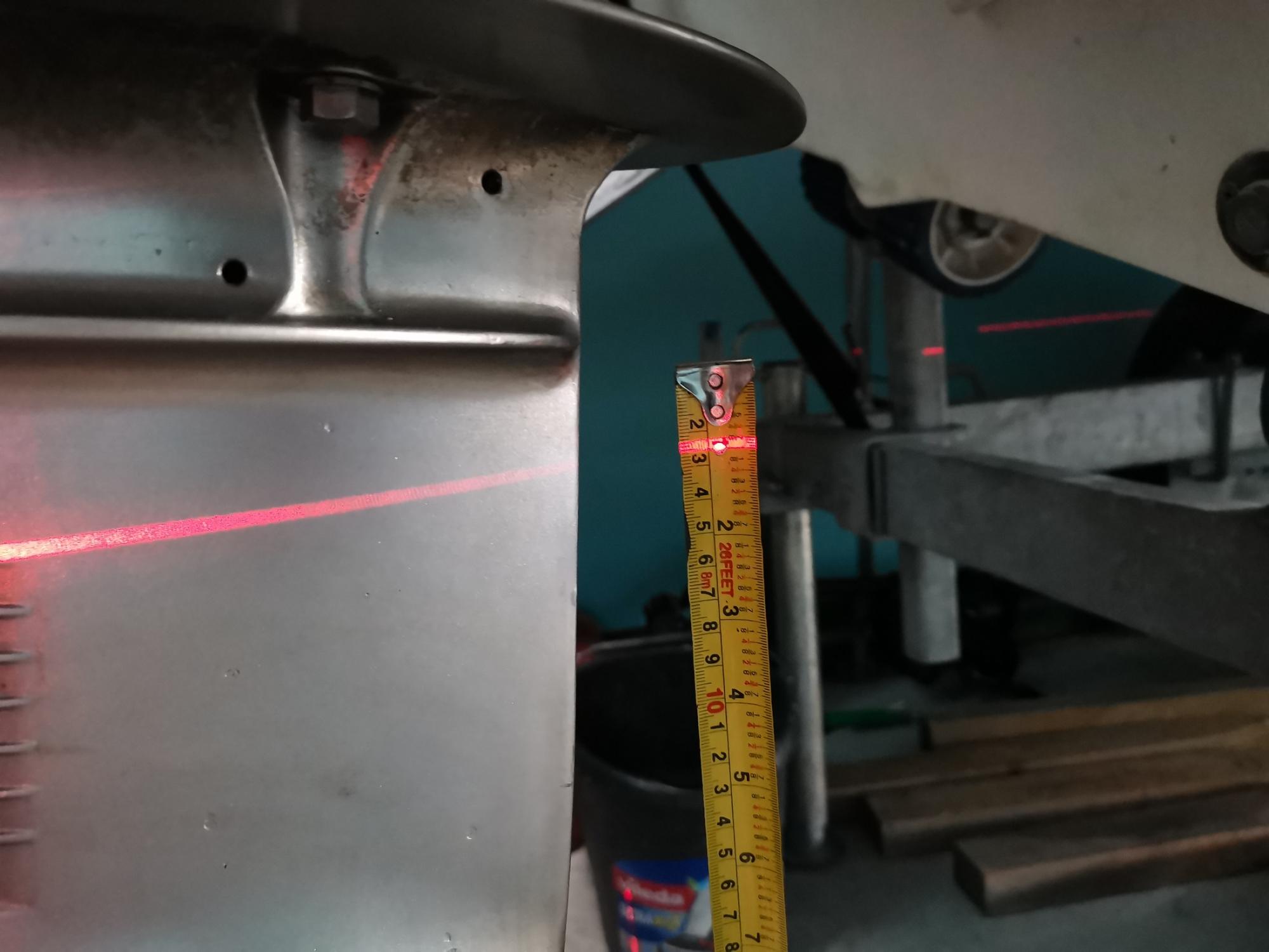

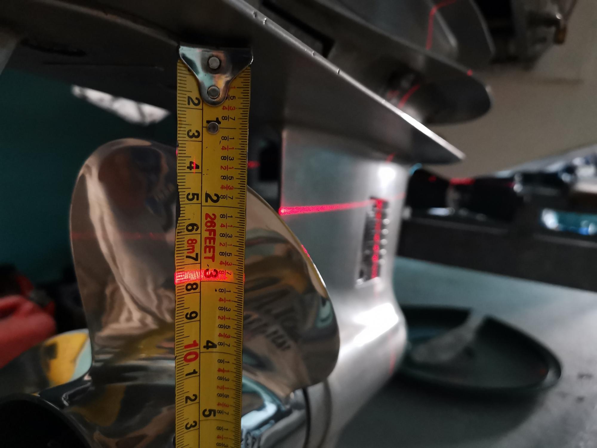

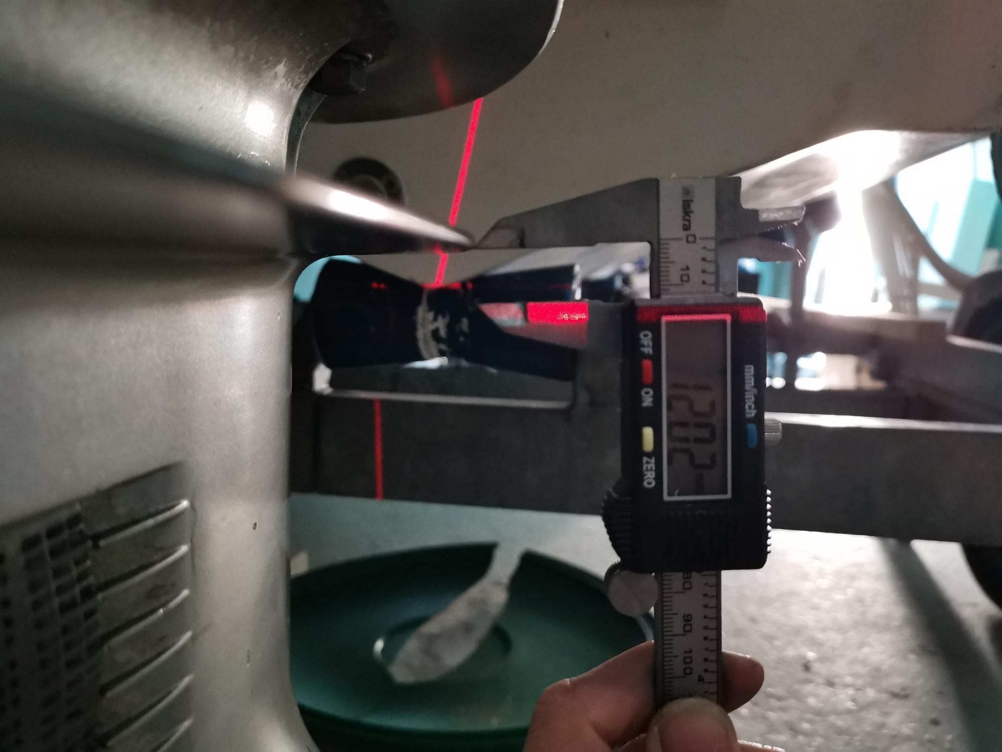

I'll try to upload some pics (noticed that is problem here :D).
OK, looks like I got it

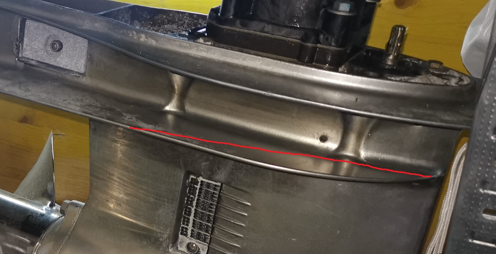

the idea ... somewhere along this line

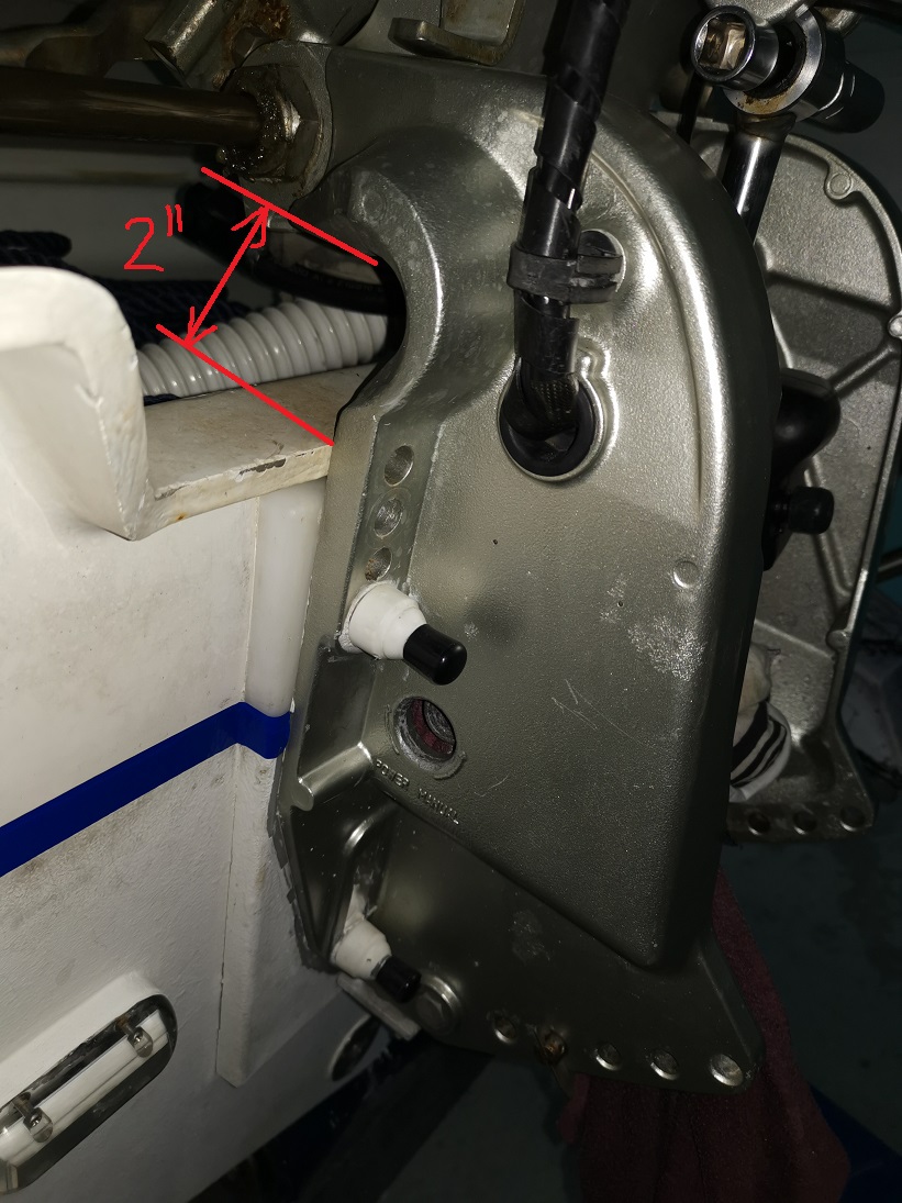

... transom position ... just FYI - I had to re-drill upper holes to new position already becouse rigger messed it
at most up position there was 1/2" more available space at bracket slots.
... parallel to keel
... at cruising trim out (80%)
spray at max trim out
