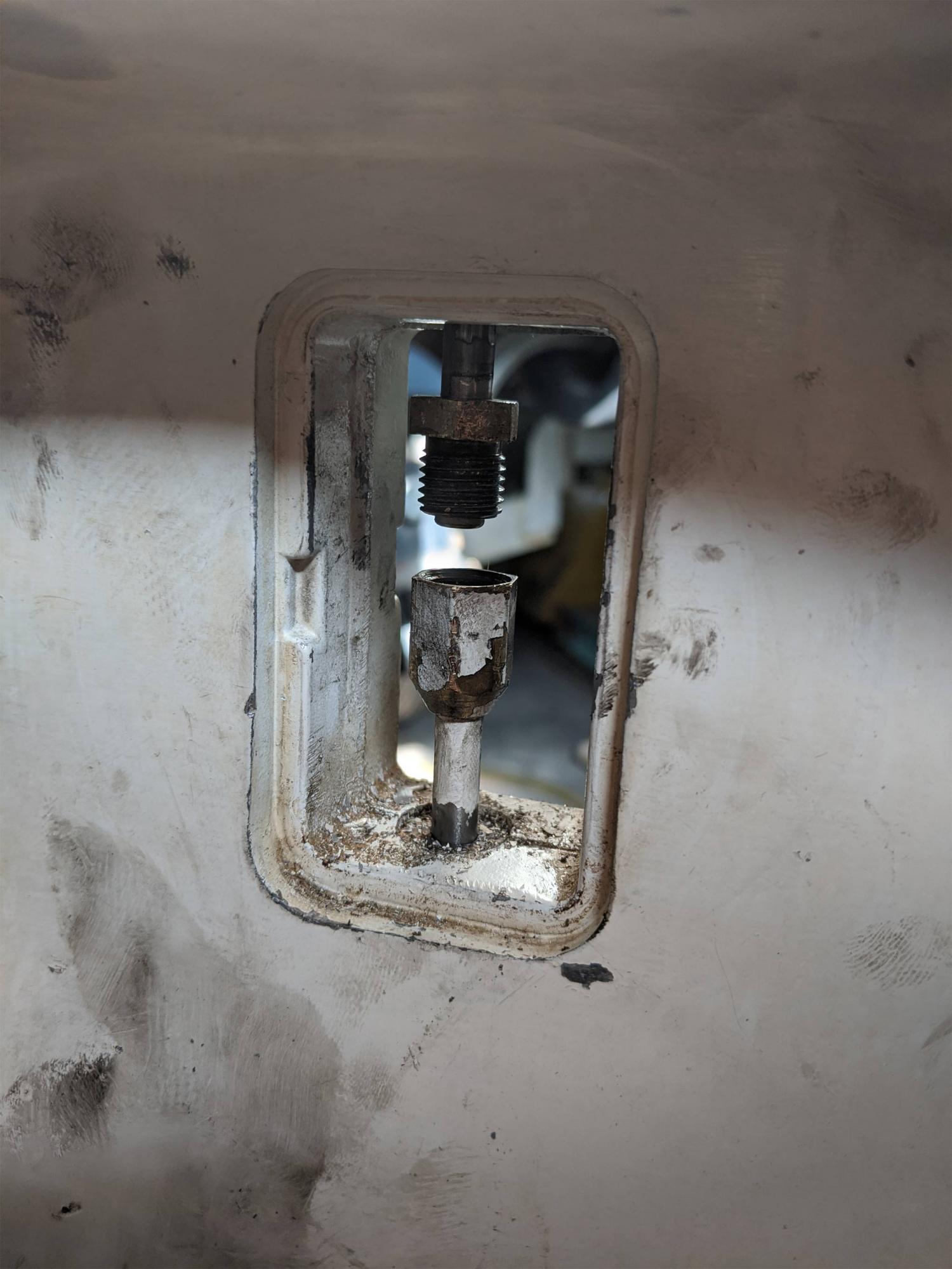

I actually did smear a bit of sealant over the wee gouge prior to pressing the seals in the hub. When you say shift rod o-ring do you mean there is an o-ring where the lower metal shift rod enters lower unit in image? If so I did not monkey with that. Is that removeable?shift.jpg
I actually did smear a bit of sealant over the wee gouge prior to pressing the seals in the hub. When you say shift rod o-ring do you mean there is an o-ring where the lower metal shift rod enters lower unit in image? If so I did not monkey with that. Is that removeable?View attachment 23600
Yes.Look at the parts diagram.O ring down inside the brass bushing where rod goes thru.
Hells Bells. I see it in diagram. Let me guess, a special tool is required to get that out? Is there a MacGyver method perhaps?
Method I heard of ,,remove shift shaft and tap brass bushing with 1/4 x20 thread and use a piece of threaded rod and a steel plate and nut to act as puller.
Thanks that sounds like a good idea. So the shift rod just turns out like a bolt then? It must be threaded on the end I can't see?

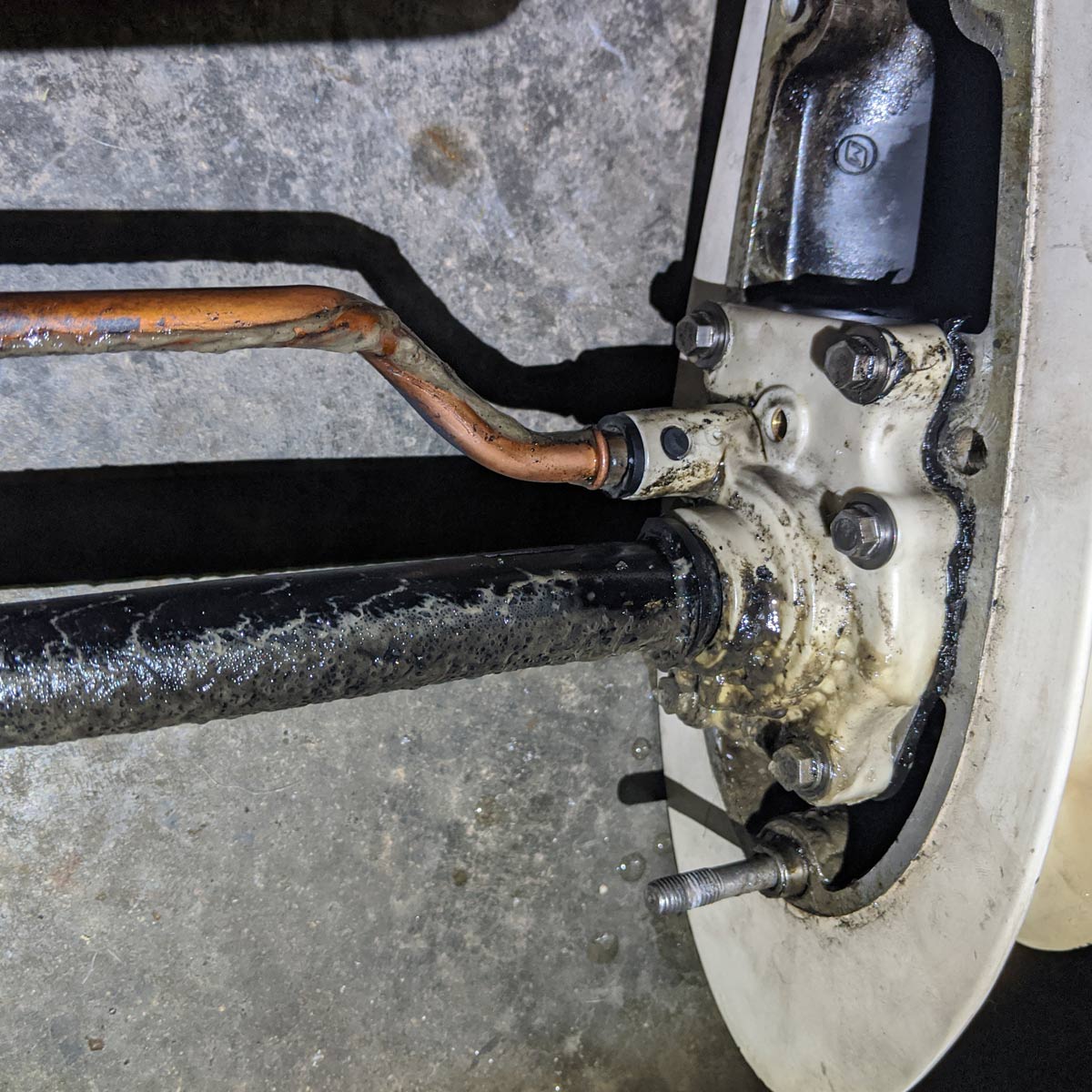

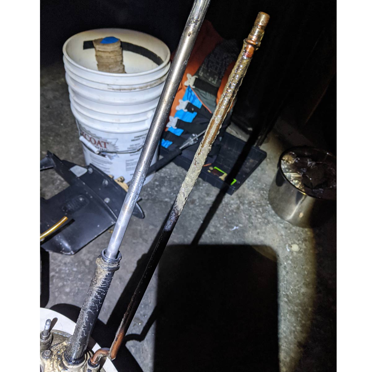

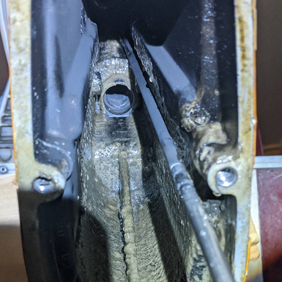

I pulled lower unit today and pics are below. The first time I pulled it when changing water pump the copper tube stayed in the upper, this time it came down with the lower. Not sire if that matters. Grey sludge everywhere with ooze marks possibly indicating it's running down the copper pipe? Any ideas? TNX
UPDATE
I bought a used lower unit with new water pump installed in it. The lower was pressure tested to 12 PSI. I bolted it on and pumped it full of fresh oil. Hit the lake and motor ran awesome. Tons of water coming out of exhaust/pee hole. Get back in and check lower and lots of water mixed with oil. So I now have 2 lower units, both with new water pumps that work great, yet when I put either on motor and run it and check lower the the oil comes out with water in it. So, if you have a lower unit that is sealed well, what could cause it to become infused with water so quickly? Back blast from the exhaust or something? I'm confused....
Yes that lower shift rod screws right out.-----A 5/16-NC tap works a lot better in the bushing.
Thanks, Do I have to unscrew the phillips screw next to the bottom drain plug before I attempt to unscrew the lower shift rod and pull it up through the bushing and o-ring?
Do not unscrew the Phillips. I don't mean to butt in,I just have one guestion,are you concerned about water in you lower gear oil or the emulsion in your midsection?
Thanks! There's water in lower unit after replacing water pump and ever seal except the shift seal. That's my main concern. Is the emulsion in lower something else I should be concerned about?
