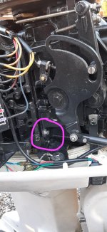

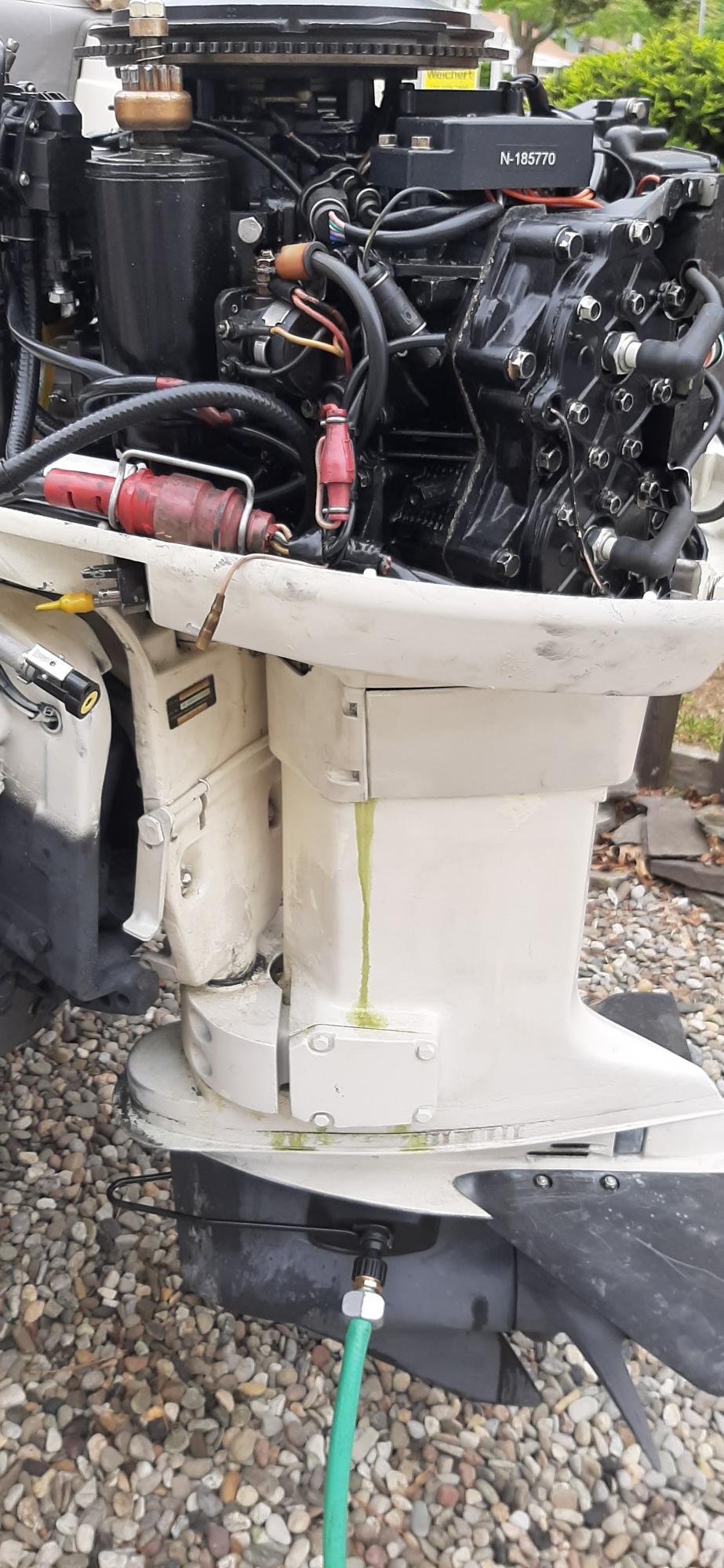

Hi everyone, first time on boards, I thank you all in advance for any help with this issue. I own a 1990 90hp Johnson, model VJ90TLESB, she just got carburetors rebuilt, compression on all 4 cylinders 115psi, starts and planes fine. Carburetors needed rebuilding due to the bowls being warped and leaking fuel. I thought this was the problem with a constant drip line of fuel coming down the midsection of the motor (see pic). Even running engine out of fuel still causes this drip line of fuel. Upon further investigating, I noticed one of the crankcase bolts loose (starboard side, see pic), trying to tighten it, just spun in place. I backed it out and someone before me helicoiled the bolt in but it was now loose. I retaped hole with 1/4" 20 tap and recoiled hole, added red loctite and new 1/4"-20 bolt which was a bit longer to grab more thread. All worked fine, started engine right up and runs fine, but clearly did not fix leak. The hole that I retaped has a lock pin right below it.
1) Could this be the cause of the leak?
2) What would cause this bolt to loosen?
3) Could the gasket be compromised causing this drip?
4) Any ideas of what to do? (obviously pull power head and tear engine apart up to this gasket is already in the back of my mind)
Thanks for any help in trying to save my family from a summer of no water fun.
