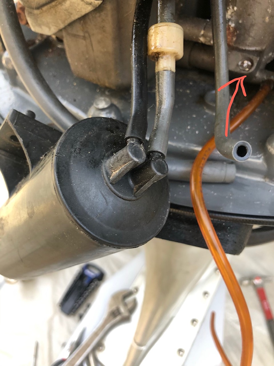

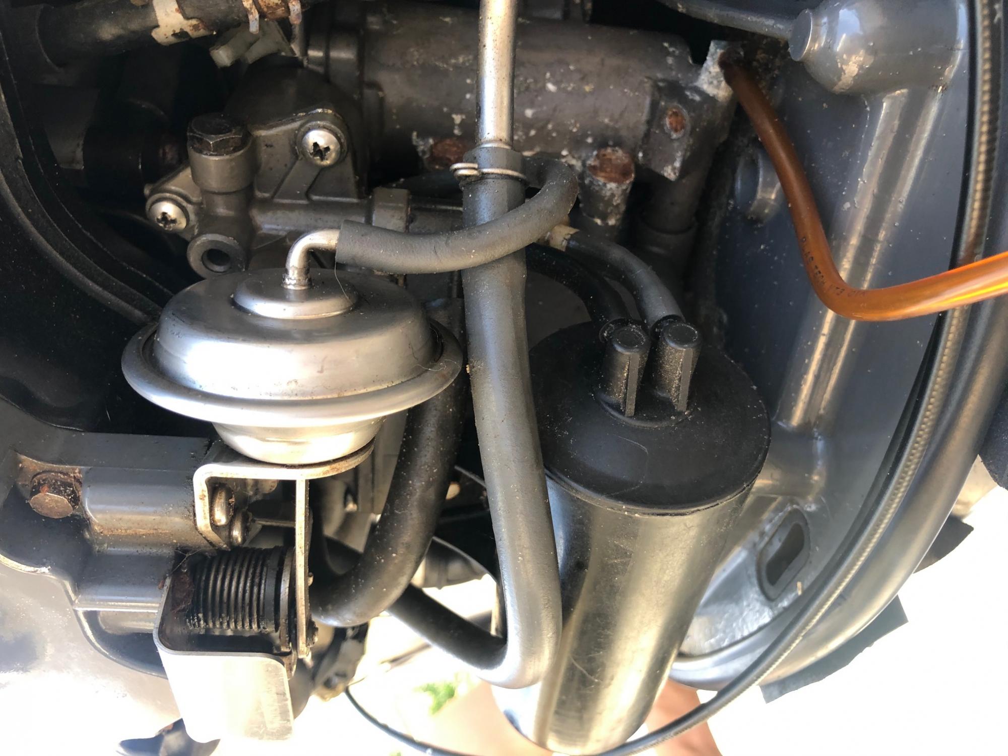

    So here are some pictures of my vacuum tank, you can even see the stripped bolt on the side with an arrow.
    @CHAWK - which hose is the one that i should be following that is connected to the hose?
    also, what part of the diaphragm am i pulling back to see if it snaps back in place? The instructions were not too clear (to me).
    Thanks again guys.

    As for the pictures - I think you are looking at the wrong diaphragm.
    See item #4 in this diagram: https://www.boats.net/catalog/honda/...ntake-manifold
    It's the diaphragm on the bottom of item #4 that I was talking about. And you can see where vacuum hose #23 connects to the IAB solenoid, #9.
    CHawk 25 DLX

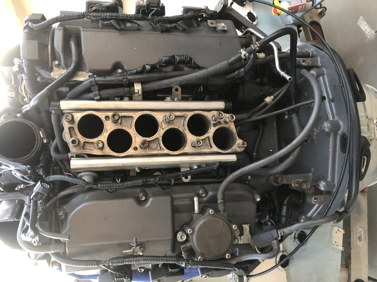

    Well I got home after work and started wrenching,
    i took a look at the IAB and it was flickering right on when I turned her on and tested while the engine was off, I flickered it with my finger and it’s very much working. I checked the lines and everything seemed great! I even tried to inspect them on the inside. Couldn’t find holes, cracks, tears.
    so I started doing the cylinder drop test, it seems every single spark plug was working and you can tell the different when I took out the plug.
    i checked the throttle body wires, they were in spec and not any extra play and was sitting on the top and sitting back on the stopper.
    i need to do a fuel pressure test but have no idea what tools I need to be asked to do. I’ll try some research.
    gah this is very frustrating I honestly don’t know what to do from here or if I should just go ahead and take it in the shop..was really trying to get away from that.

    On the cover to the HP fuel filter there is a fuel pressure relief bolt. That's where you measure fuel pressure. You need a 6 mm adapter. Spec is 41 psi to 49 psi at idle, if my memory is still good.
    Why did you remove the entire intake?

    Hey Chawk, I'm not sure why it uploaded that picture, it was supposed to be the picture of the IAB. Might have accidentally clicked that one instead.

    Saw your photo and that makes me curious. When/why was the intake removed? Was it closely inspected for warpage and cracks? Was it properly reinstalled using new seals and gaskets? Were the torque specifications and tightening pattern followed?
    I ask because your description of the problem sounds suspiciously like an intake leak or, possibly, a defective MAP sensor to me.
    This being a speed/density fuel control system, it's common for intake leaks to increase idle speed as the manifold pressure increase
    Of course, a skewed map can do the same but is easy to check with a handheld vacuum tool and a multimeter.
    Good luck.

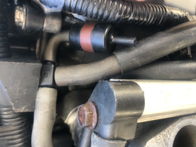

    Default Re: 2002 honda outboard woes
    Going ahead and doing valves, noticed this is not connected to anythingClick image for larger version.

  28. #28
    While using the feeler gauge for valve 6, I found it to be tightened so hard I couldn’t even get the feeler gauge to go through to measure
  29. #29
    Okay so everything has been adjusted to proper specifications and I can tell you the guy had 4 and 5 super loose while #6 was as tight as a rock where I couldnít even gauge it with the feeler.
    now my question is, what is the picture I have listed? It wasnít connected to anything, is that a purge for air or where should that be connecting to? I tried looking at the diagram I just donít know exactly what Iím looking at or for.
