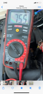

First I verified its definitely initiated in the temp warning alarm circuit, I pulled the yellow wire out of connector at ICM and other end at temp sensor, good continuity(under 3 ohms) while pulling and shaking the s%i* out of the harness, never blinks. If I ground the yellow wire to t-stat housing (proved grounded, again under 3 ohms resistance) repeatedly I get the alarm maybe 1 out of 5 times, also alarm most time wont stop even after pulling the ground, just keeps on buzzing until I pull the tan/blue wire from other ICM connector to remove continuity to buzzer. Ah hah, its the relay (or whatever) in the ICM.
What I did is pull the yellow terminal out of ICM connector and tan/blue from other ICM connector and splice them together. Now alarm system functions as should. If I heat temp sensor to just under boiling (inexactly 190 degrees) it closes and sends ground to buzzer as designed (just not through ICM). IR thermometer says engine is running at 168 degrees, Now take all that money you were going to spend on t-stats, impellers, hoses, water pumps, sensors and put it in the gas tank.
