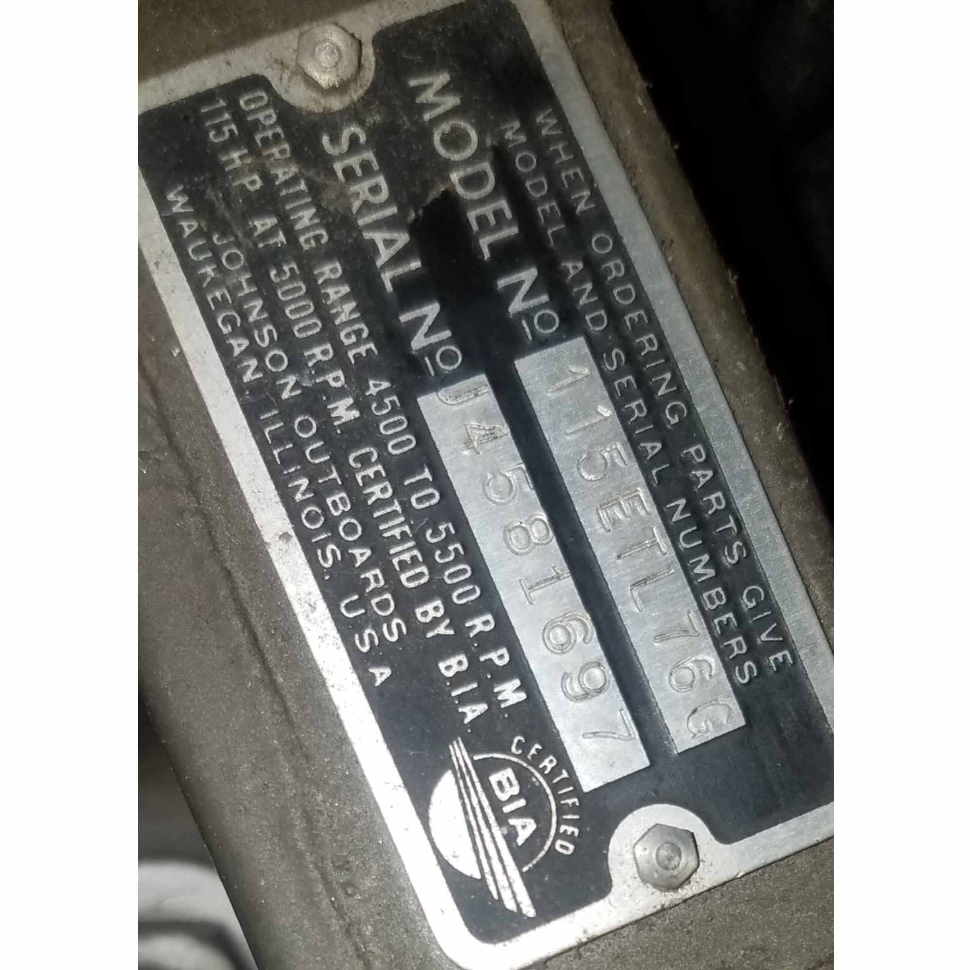

Hello,
I am new to this whole boat scene, mainly I am familiar with cars and diesels. So I am kinda out of my element. I recently purchased an old skeeter bass boat. It has a Johnson 115 on the back, I am trying to find parts for it but the model number doesn't match any Johnson motor. The model #115ETL76G and the serial #J4581697. When I look up those numbers on any boat part websites nothing shows up. No sure if maybe this id is incorrect or what. Any help would be greatly appreciated.Untitled-1.jpg
Your motor is a 1976 model 115 HP-----There is nothing special about it.----Do a complete evaluation of this motor before spending any money on parts.----Do yourself a favour and post the compression test numbers here.------What parts are you looking for at this time ?
Looked it up for a 1976 model EVINRUDE 115 HP model .----Be the same motor.----Every body seems to start off with rebuilding the carburetors.-----That has me puzzled to say the least.----Your location ?
