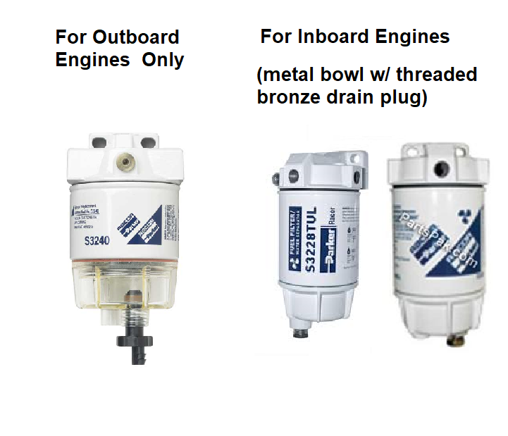

If you suspect that your fuel tank may have debris in it, I would suggest the Parker/RACOR system for inboards (metal bowl).
The Parker/RACOR is available as a complete kit, or as a retro-fit cartridge and metal bowl only.
If you go with the cartridge and bowl only, you'll need to know which OEM base you have now (thread size/pitch).

If you go with the Parker/RACOR, be sure to mount it high enough so that you can get a catch container safely underneath it.
