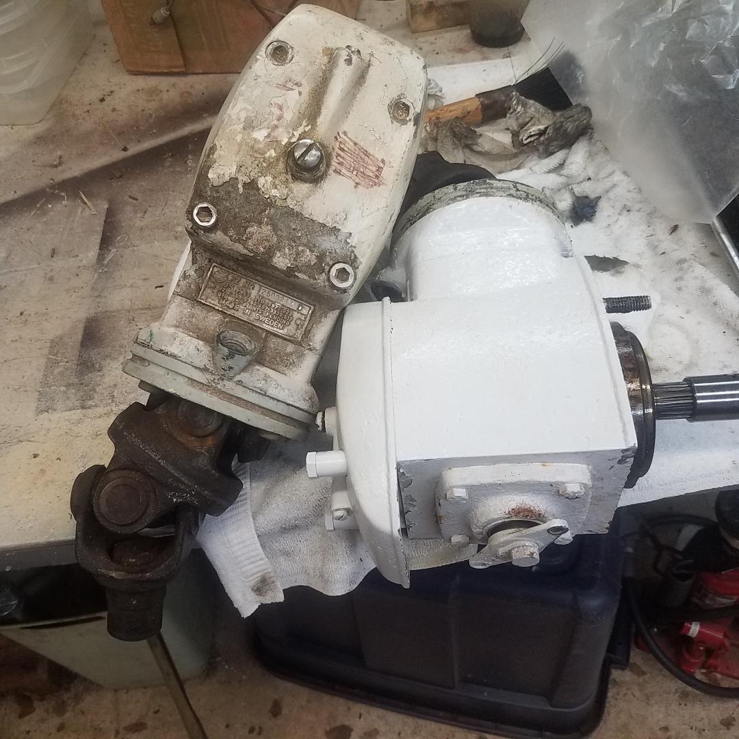

Trying to help a friend doing a transmission swap on an Aquamatic 250.
Several questions:
The white one (coming out) has posts sticking out of the top. The donor trans doesn't. Will this be a problem?
At one time, those may have been for a bracket used for steering a kicker engine.
If you don't need them, no issues.
