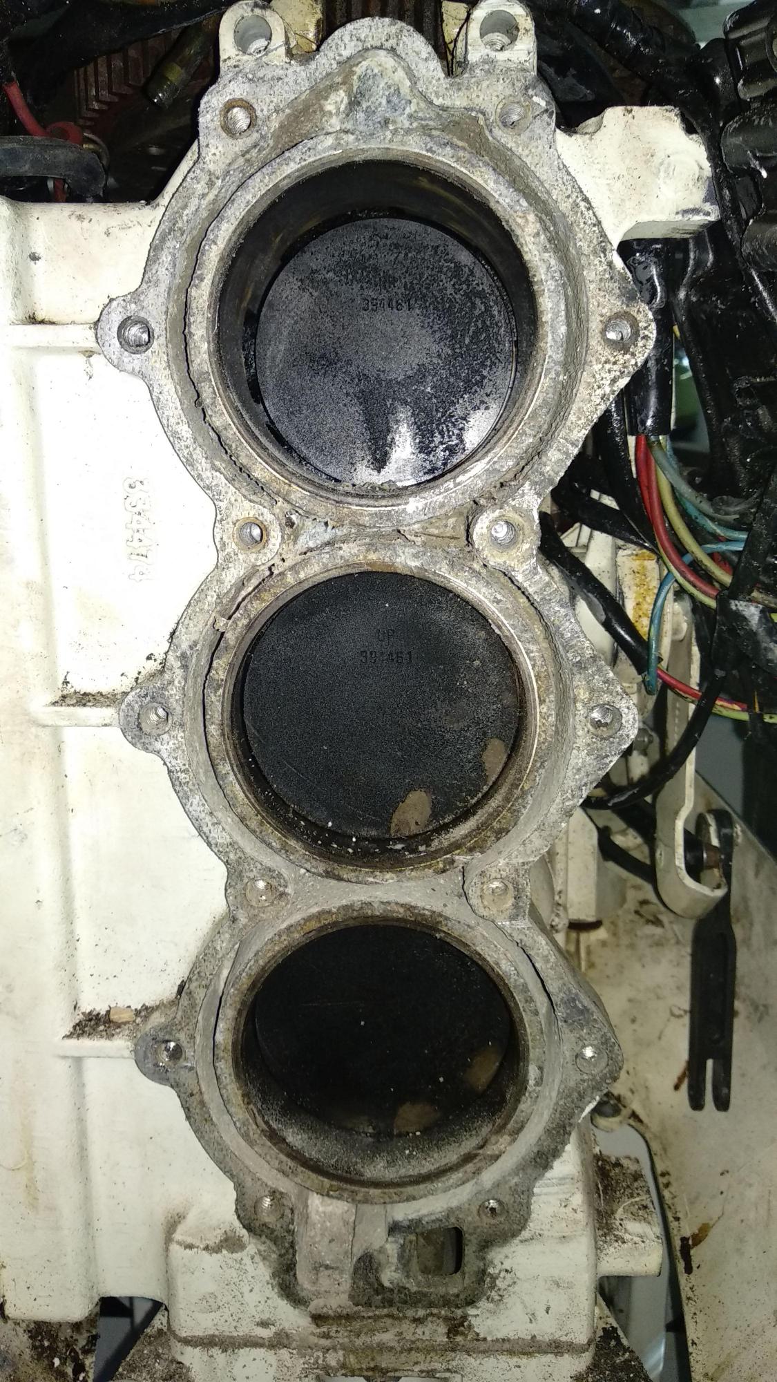

Ok, I've received the new gaskets.
I've been doing some final clean up in the jackets and mating surfaces and their is a fair amount of pitting.
In this first image the pitting can be seen on the aluminium around the bore in the top right. The aluminium is worn to the point I can catch my fingernail on the cylinder sleeve if i drag it toward the centre of the bore. There is also a small deflection on the edge of the piston which can be seen in the photo.
Is this suggesting exhaust gases have been getting out, or water has come in at some stage and damaged the piston?
If I go ahead with a clean head and block, and new gasket, will it clamp it shut or is this a complete deal breaker?
Thanks,
Ben
That mark on the piston is a concern.----Any good pictures of the cylinder wall area with piston at the bottom ?-----What was your motor doing / not doing before you took the head off ?
The mark on the piston is aligned about 2/3 of the way up the the visible intake port. There is no corresponding damage in the bore. The same goes for the other cylinders, and the facing top edge of all 3 cylinder sleeves are flat and without damage.
I purchased the motor second hand. My initial problem was an overheating with what I thought was due to a failed water pump -- no water out of the telltale. I took the lower unit off and it was destroyed. I replaced it and the motor ran well, like it did before the pump failure, but at consistent higher revs it overheated again - constant alarm sounding. I waited a while for it to cool down, and drove it home at a slow but not crawling pace, about 15-20 minutes without issue. This is when I decided to remove the head for inspection. The water jackets were fairly crusty, but not blocked.
This photo was taken before I started cleaning the cooling passages. I may have poked around and cleared a little of it.
Give it a try, be sure to surface head too. Nice clean up job. Cylinders look okay. How are threads, how did you clean them? If bolts are decent reuse them or I can find you some sweet used ones.... Minnesota fresh water. Tim's Outboard Hackensack MN 218 682 2331, Mike or Dan.

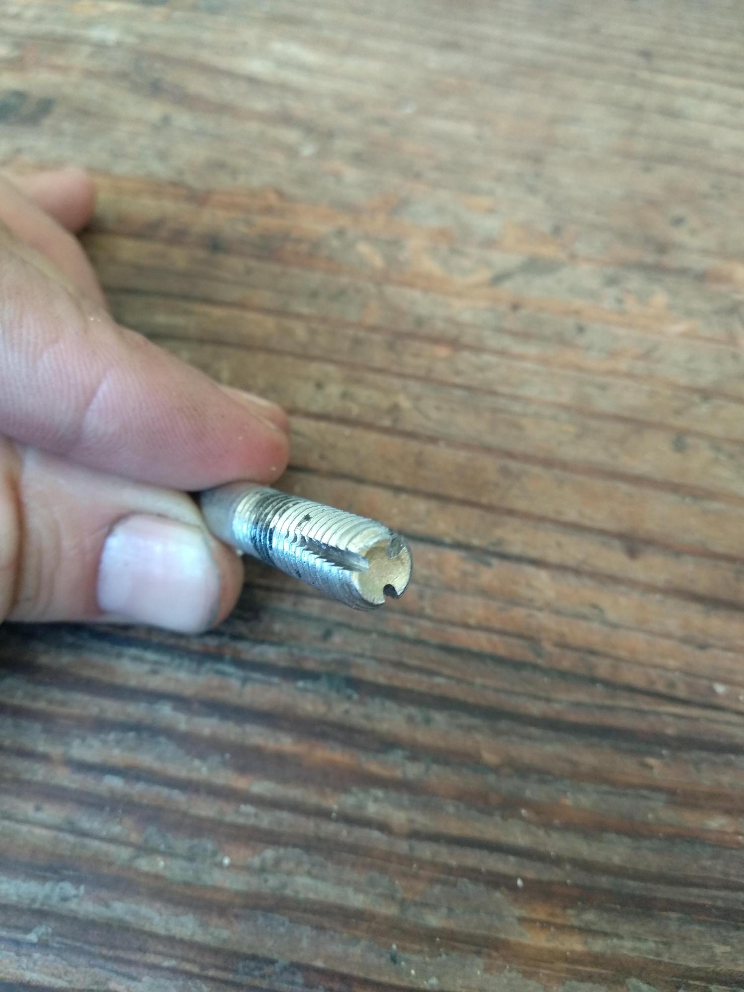

Hi Tim,
Bolts look ok but need dressing up. I think I will soak them then buff them up on a brass wheel. Cleaning the threads I'm not sure about. I was going to try using a tap but apparently that might not be suitable. I have spare bolts so I was considering notching one of them to use as a chaser. I will keep you in mind if I need any spare parts.

I made up a little thread chaser.
I lubed up the block threads and spun it in every hole by hand with no resistance, and all the gunk came out nicely.
I was thinking about applying the anti seize to the chaser and running it in and out of each hole to coat the insides thinly and evenly before I go about putting the head gasket on. What do you think?
