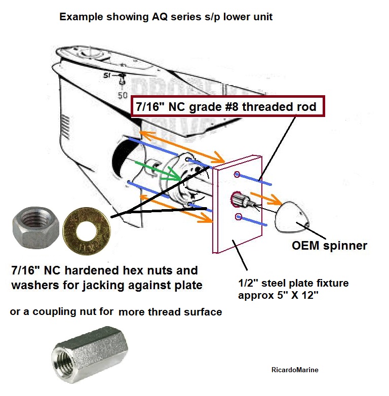

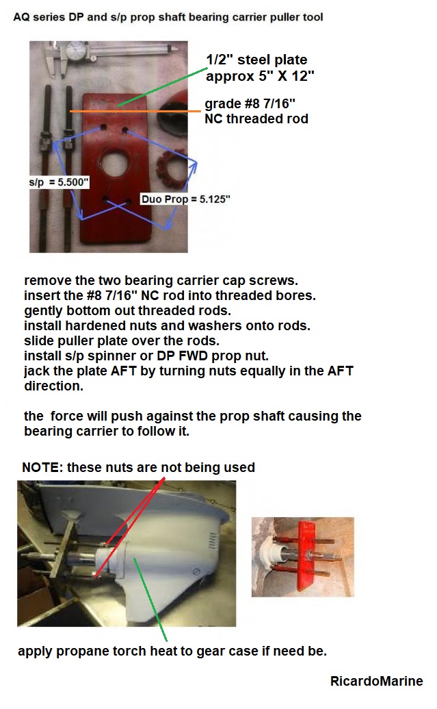

You’ll need to build one of my prop shaft bearing carrier puller tools in order to remove the carrier. This will allow to see all three gears and one bearing race.

Fishmaster, here are a few photos of my prop shaft bearing carrier puller tool design.
This tool works on both the s/p and Duo Prop lower units.
