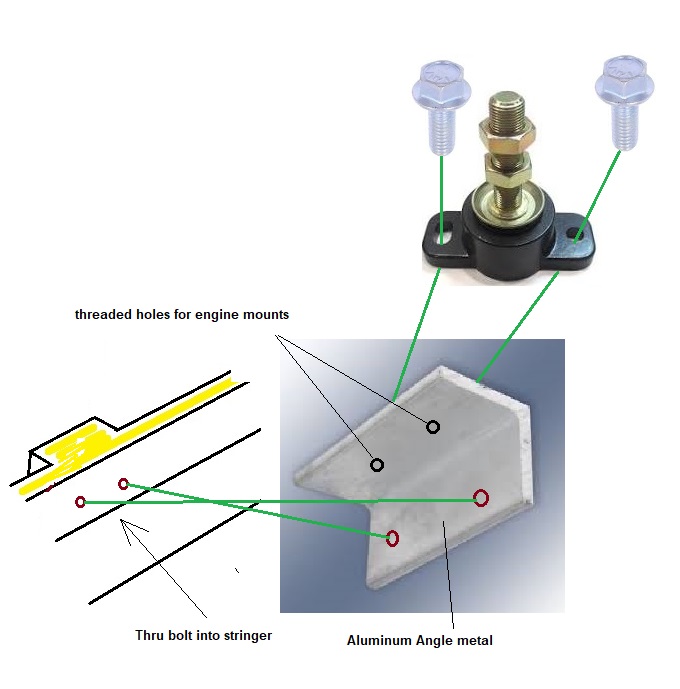

    Has anyone suggested thru-bolting an angle metal engine mount support?
    It would be a decent temporary repair.
Name:	Stringer  engine mount support 2.jpg
    You would slide these into position, adjust the height and fasten the engine mounts to the angle metal, then drill into the stringers and install the horizontal bolts.
