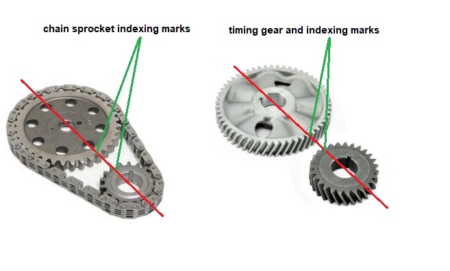

You should see the timing chain sprocket indexing marks similar to that of the SBC.

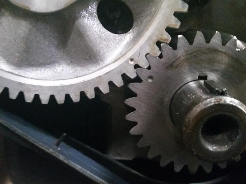

what I have found so far after getting the front cover off, is the marks are mated correctly in relation to one another, BUT.... at TDC, the dot marks on the gears are about 1 tooth away from where they should be... instead of them being at their closest point to one another, TDC comes up before the marks get to their closest point (a strait line from the center of the crank rotation to the center of the cam rotation, the marks should center and line up perfectly behind this line)....
the indicator mark on the crank timing gear seems to be off 1 tooth, as one of the valves is still open slightly... it appears the cam is retarded 1 tooth.
to solve the problem, I have loosened the rockers and removed the lifters, then pulled the cam and rotated/advanced it one tooth to the position it where it should be in relation to true TDC (the gears are pressed on, both the crank and the cam).... now, after replacing the lifters in #1 cyl, the valves are both fully closed and I can rotate the crank back and forth several degrees without movement in either of the #1 lifters.
Not good!

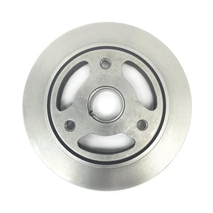

Ayuh,.... I don't have much to add, other than the fact that the 153", 120 hp motors don't have a harmonic balancer,......
If there's a harmonic balancer on it,...... It's a 181", 140 hp motor,......
Bill, are you certain about that?
This is listed as a Mercruiser 2.5L 55045T harmonic balancer.
https://www.ebay.com/p/17016718544?...S12m5rDBrUNytgt8ZdynHSzpfrRwMRfcaAtlUEALw_wcB
Also, I think that I was incorrect regarding the chain/sprocket timing set.
It looks like the 2.5L may have used a gear set.
that balancer is what mine looks like.... I have also read that the 153 (2.5) does not have a harmonic balancer, but it seems this may be incorrect.... which is one of the reasons I was looking to get the engine code deciphered, to find out what it actually is... it says 120 on the outdrive and its supposed to be the original engine for the boat, which is why I assume it is a 153ci...

also, the cam timing gear has no retaining bolt, but is firmly pressed on, as is the crank gear.... I talked to a machine shop and they said these are serviced by removing the cam/crank from the block to remove and replace the gears, if needed.... the cam itself has a thrust retainer held by screws that are accessed thru the holes in the gear.
at TDC (checked by piston stop), and with the crank keyway is at 12:eek:'clock as it should be, the gears mesh like this... it looks as if the crank gear dot should be advanced 1 tooth, so that the dot on the cam gear could mesh properly.
the crank rotates to the right, turning the cam gear to the left.. this shows the cam to be retarded 1 tooth due to the crank gear being indexed wrong...
but im not sure that the position, set up as shown would cause a need for the base timing to have to be 16degrees advanced to make it run...
and, by advancing the cam gear 1 tooth so it meshes as it should (regardless of the dots on the gears), will that allow the base timing to be retarded from 16 BTDC, back to its spec position at 6-8 BTDC?...
If what you listed as the 'serial number' in your original post is really the engine code (which is consistent with the latter info),
then you don't have the original engine, you have a much newer 181 CID block.
regarding the cam gear phasing, there's nothing wrong that I can see in your picture - the crank's absolute position in the block is irrelevant.
agree with mako mark these look correct
the engine code I have listed is correct, and if it decodes as a 181 and not the 153, this would explain a couple things ive wondered about.... and way helpful in getting it set up to spec.
the cranks absolute position is irrelevant?... even if one of the marks shown is in the wrong place?.... I called several cam manufactures today and Isky Cams is the only one with an engineer available to talk to about the problem. he said exactly what I suspected but wanted to hear from someone else. IF the can was retarded in relation to its designed position of the crank, the base timing would have to be many degrees advanced of where it should be.... he agreed that a gear being indexed wrong was not common but it does happen, causing problems like this.... If this is in fact the problem here, this will be the second time in my life that Ive had this issue...(firts time was on a dodge 360 engine)....
I agree with Mark.
Since the crankshaft gear is indexed to the crank via a key and key-way, there is no changing this.
Since the camshaft gear is also indexed to the cam (most likely doweled), there is no changing this (unless you enlarge the alignment dowel bore and use eccentric bushings).
As long as the two dots align, all else is irrelevant.

Centerline, from what you have shown us, your marks are aligning correctly.
I have reassembled the engine this afternoon and will see how it runs tomorrow....
Just make sure that when you roll the crankshaft around, that for every 2 crankshaft revolutions, the two marks align as you have shown in your image.
This appears to be correct!

If you change this indexing, your camshaft and crankshaft will be out-of-phase with one another.

Bill, I trust your expertise..... however, why am I seeing a harmonic balancer listed for the 2.5L 4 banger?
Are these ads incorrect???
Ayuh,..... That would be my guess,.....
I trust the parts listin's here at marine engines way more than ads on ebay,......
Rick
why you see chain sets sets listed for a gear drive application is based on a quick google search
