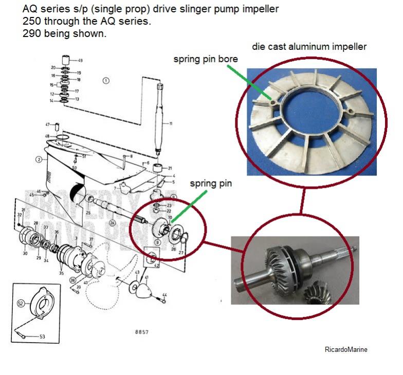

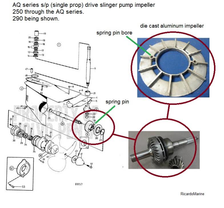

Here is a better view of the die cast impeller.
This should better explain how it mated and pinned to the driven gear.
