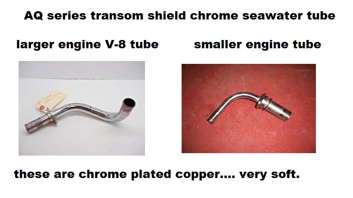

Here is the chrome suction side tube that penetrates the transom shield.
These are chrome plated copper and are extremely soft.
Use caution if removing one.
The S hose joins these two parts in the line of seawater pump suction.
