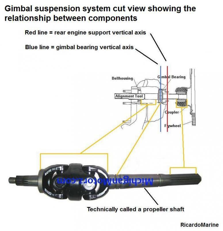

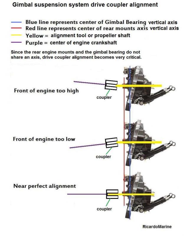

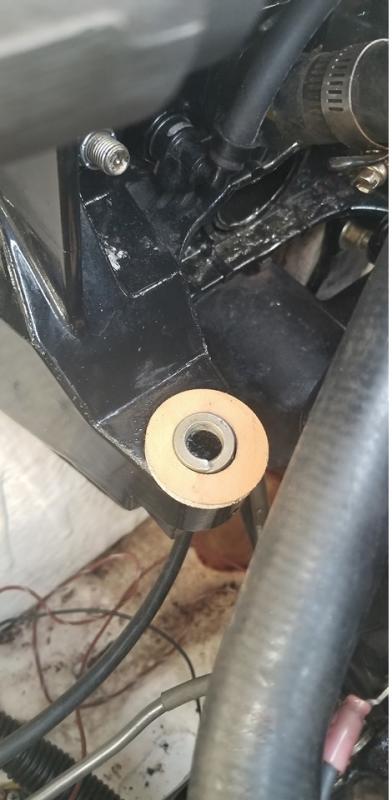

So I purchased a new GM 3.0 and a good low hours drive for my boat. It has the old style rear mounts with the fiber washers and after installing, I cannot seem to get the alignment correct! The alignment tool goes in fairly easy and the grease has spline marks all the way around but the tool still seems a little hard to pull out. Seems like no matter what I do, it does not slide in and out easy like I see in some of the videos. I tried tapping the tool with a hammer also to align the bearing but maybe I'm not hitting it hard enough? Help!
