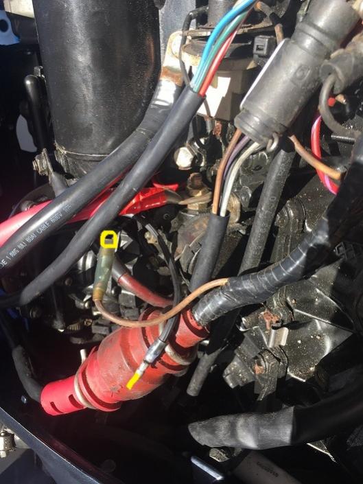

Going through an outboard that hasn't been used since 2005:
When I connect these two wires, upon turning the ignition key ON (NOT cranking the engine/just turning ON the ignition), I get the Continuous Horn alarm. I thought the continuous horn indicated Overheating??? This confuses me because the engine hasn't been started yet.
The black wire lead goes to the OIL reservoir. (It is one of the two wire leads from the OIL reservoir. The other black wire lead from the reservoir, goes to the engine's GROUND screw.) The brown wire lead is taped up in the wire loom along with all the other wires in that BIG RED Connector. (ref. pic) I'm not sure where that goes to?
Has anyone experienced this?
Of course, when I disconnect those wires, turn the ignition ON, the Horn does its normal "hello" short beep once, to let me know it's working.....then I start the engine, no problem.
*NOTE: The VRO seems to be working by pumping oil. I ran it for 3 hours the other day in the bay and noticed the level of oil was LOWER afterwards, so the VRO pump is working...i believe. As a precaution, I'm also running pre-mix in the fuel tank.
