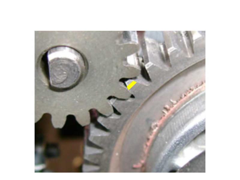

Like to show you a picture of a good spur gear contact pattern and mine is just a mm or 2 shown in yellow. for hydo-lock, Pinion should just stop as it did a couple of times if contact pattern was correct. Sloppy design.
View attachment 21665Learning something new every day. Damn, have to change the manifolds and risers too. Still Do not know why. Don't they just have water jackets casted in them to separate exhaust from water and gaskate between them? Are you saying that cast iron wall between exhaust gas and water totally rusts out? I will check that and replace if needed.
that photo is a constant contact gear to gear, your dealing with a bendis that is throughing a gear into another.

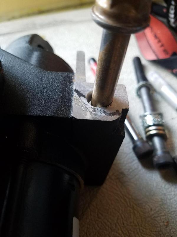

Well, had the starter modified so it is 2 mm closer to ring gear. Put it in and removed all spark plugs and to my surprise water came out of couple of cylinders. crank the engine and starter worked fine and no noise. Did cranking a few times and then put in WD40 in all cylinder and turn it again to lube cylinder walls. Now I have to after risers and manifold to find out where it is leaking into cylinders. It is probably the gasket since I cannot believe 1/4 inch of steel wall can be rusted through. If that is the case, we need to change cylinder block every few years too. Thanks for everyone's help.
I am curious as to this starter motor modification!
.....Bolt bores plugged and off-set re-drilled?
.....Bolt bores elongated?

thumbnail.jpgthumb.jpgThanks Rick for discussing my issues. First thing, I do not like 1-2 tooth contact, no gear is designed like, obviously it works as long as there is no hydro lock. It will be sheared of with hydro lock due to inertia effect. It should just stop turning crank with no damage unless a different cylinder fires and bend the rod. BTW, I worked for GM for 35 years as an engineer. I think the block is bored correctly but merc and after market folks just did not do it right. Here is a picture of starter hole elongation that made it 2 mm closer to ring gear.

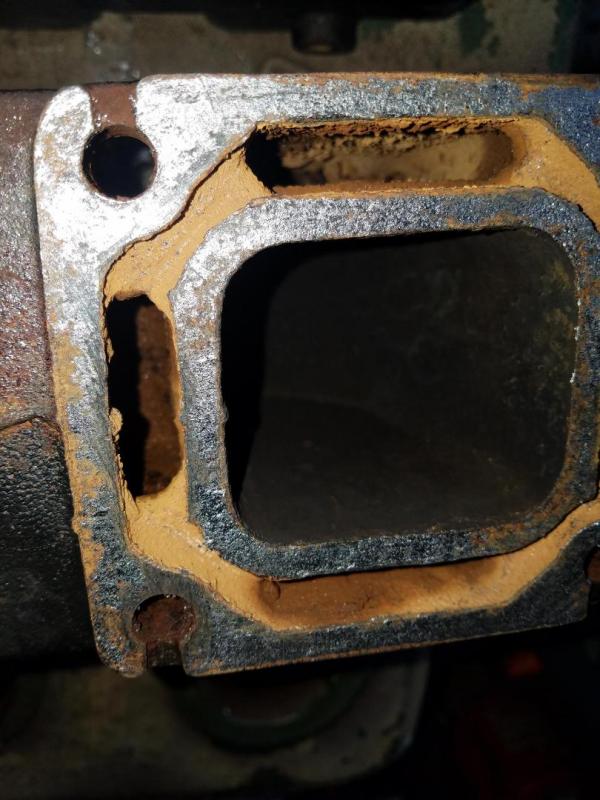

After work, removed the riser and picture of one is attached. they both look perfect, no rust thru as long as I can see with camera. I think changing manifold and riser every 5 years is total non-sense. Look at mine, they are 32 years old. Gaskets were both in pretty bad shape as that is my fault. I had to remove risers a couple o times but did not change the gaskets. I am going to take Bt Doctur advice and test them for leak anyway, It will cost me $30 worth of gasket to check them. Thanks Bt Doctur.
No disagreement there!
Being an engineer, you certainly know why the starter motor nose housing mounting bolt bores are to be a tolerance specific size.
The knurled areas of the bolts are to serve as alignment dowels.
When/if the nose housing bolt bores are enlarged, this dowel/alignment affect is removed from the equation.
I believe that you mean exhaust elbow. (see my image in post #38.)
Agreed..... the transfer ports and the material between them and the main exhaust chamber look to be OK.

*** take the exhaust components in to a machine shop for cleaning a magnafluxing. The magnafluxing process will find any cracks.
If need be, a machinist can true the mating surfaces by using a machine shop surface sander. It should take him no longer than 5 minutes per each surface!

Prediction.... The starter will now move and or snap the bolts.

Had he over-drilled, pressed an aluminum bar into those bores, and then re-drilled the off-set bores, it may work!
