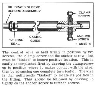

Hi, replacing control cables in 1975 Johnson single lever controller. How are internal thread cable fasteners inside controller removed replaced...thanks
Same both ends except control end has allen head setscrews. Insert wire into control end casing guide till even with end of the guide.
