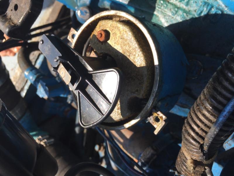

Please have a look at the attachments. What is this part? It is inside the distributor cap and it got fried. I’m asking about the part that looks like a donut, but not as tasty.

Not to say it replaces them. But it's a primitive solution that the engineers came up with. It looks like a prestolite distributor used in omc cobras 4.3l. Those parts are no longer available. But if you do find one . Let me know.
You could try an aftermarket solution. Look up pertronix ignition systems. They may have a solution for you. I've tried them on a 94 omc cobra and found the magnetic rotor they supplied does not fit the reluctor in the distributor. In my own problem I may just swap out the old distributor and go I the direction of points so I don't have to fiddle with modules and rewiring.
If that is an early Prestolite, it would be their version of VR (variable reluctor) style triggering!

The part that became fried would be the VR sensor or VR pick-up coil unit.

See post #11 again. From what I see, the OP has an early version of a VR triggering system.
The original reluctor wheel may not be removable.

Rob, were you actually able to install all of the Pertronix retro-fit kit components on this existing distributor?
In other words, were you able to remove the original reluctor wheel from the shaft, and use the Pertronix triggering wheel in it's place above that area?

I didn’t know I should try to remove the original reluctor. The new parts fit easily without removing that, but I can try to remove it. Also, I am not able to see your attachment.

It would appear to me that the Pertronix triggering wheel would need to install at the same elevation as the reluctor wheel.

Would leaving the old reluctor cause it not to work?
Typically the Pertronix triggering wheel slides down over the contact points cam. The rotor installs above that!
The sensor unit aligns with the "induction field" created by the embedded magnets within the triggering wheel.
With a VR system, the reluctor sits at the same elevation as the contact points would have, and again, the rotor installs above that!
The VR sensor unit aligns with the "induction field" created by the reluctor wheel.
*** All of these sensor plates would mount at the same elevation, be it contact points, VR or Pertronix Hall Effect.
