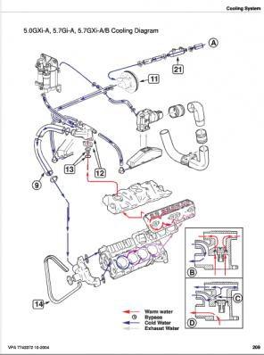

So I found a diagram online of my setup and how the t stat housing works and to me is a little dump on placement of the sensor for ecu.

When t stat opens and lets out hop water out{ this is where I am running into the over cooling } the new raw water is coming into the circulation pump past the SENSOR which is correct in that the water is cool. Thats my temp drop and after that water warms up and the sensor, Im good again.

I would have thought they would have pushed [ bypassed] some hot water back into circulation to warm new raw water.
Look at my image above.
Blue = incoming cold seawater
Red = seawater that has removed engine heat.... it is being held back by the thermostat.
Yellow/Blue = a mix of tempered seawater and cold seawater on it's way to the circulating pump.
Red/Blue = tempered seawater that is heading to the exhaust system.
