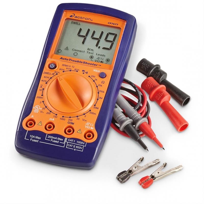

Adjustment with a dwell meter produces more exact, consistent results ...

The dwell angle is the time or degrees in which the points are closed. The less gap, the more dwell. When the dwell is right on spec, the point gap should be also according to the OEM. Generally if you have a dwell meter, you don’t recheck the point gap once you have the dwell right. You do need to reset the timing after changing the dwell angle.

A dwell meter measures the angle of rotation of the cam through which the points are opened and closed, and registers the dwell angle - the period when they are closed.
It can therefore be used to check the gap on worn points with more accuracy than a feeler gauge, and can be used without removing the distributor cap and with the engine running. The meter can also, of course, be used when fitting new points.
