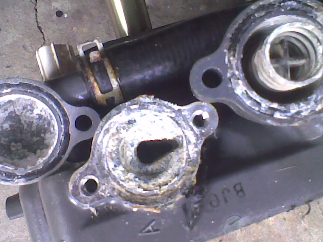

025.jpg Not to scare you this motor was flushed by the previous owner this is the flush port full of salt build up on the 130 hp at the top end of the motor its got a pressure valve inside that stops water from coming out from the motor but opens up when garden hose water pressure is on .Clean it using Durbans Formula.
