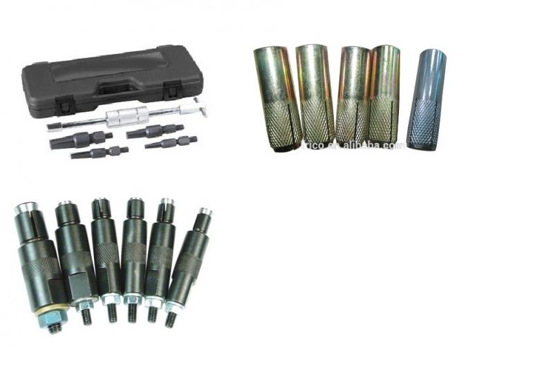

Bob, perhaps find a machine shop who owns a dead-end or blind-bore collect and slide-hammer style bushing puller.
Apply some heat to the housing as to mildly expand it a bit.
