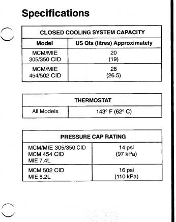

Looking in the manual I found this first.
Thermostat spec is 143 or 140 as we all use these days............

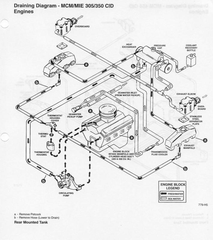

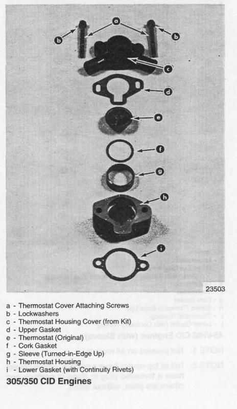

Picture of component order for thermostat housing
Here is the same basic flow diagram but with heat exchanger in back. A bit easier to follow flow maybe.
So based on first image it looks like the 160 degree is incorrect. You should swap it out to a 140 degree thermostat to start.

I also reread your last post, you have the hot water option, I didnt upload that image, I will later need to get ready for work now. Not sure that would have any influence on issue unless it was slowing down flow causing the overall circulation to be slowed.
Confirm parts in thermo housing are in the correct order.
