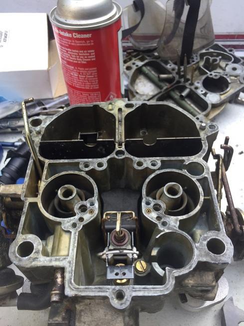

Q-Jet rebuild small.jpgAre you using E-10 gas? Was the fuel supply changed at some point in that you used to use straigh gas and now are using E-10? That can cause the exact problem you are experiencing. The E-10 will tend to clean out all the accumulated varnish in the tank. Eventually though it will be clean and you should not continue to have probems, unless you have old fuel lines that are breaking down.
If you have a Quadrajet carb, I can tell you that while they are not hard to rebuild, the idle emulsion tubes are hard to get clean, some say to remove them but I just soaked mine really well in carb cleaner and then blew it out with a good air compressor. Also, I have heard that unless you use a good E-10 resistant rebuild kit the accel pump seal will degrade due to the ethanol. This might be part of your problem. And lastly, a lot of people make a mistake when reinstalling the float and needle on the Q-Jet..the little clip....is not supposed to be in the holes on the lever, its just supposed to hook on to it...putting it in one of the holes, can cause the float to stick and flooding....

View attachment 20875Are you using E-10 gas? Was the fuel supply changed at some point in that you used to use straigh gas and now are using E-10? That can cause the exact problem you are experiencing. The E-10 will tend to clean out all the accumulated varnish in the tank. Eventually though it will be clean and you should not continue to have probems, unless you have old fuel lines that are breaking down.

New pump came in, ive taken it out twice with it. Still no luck. The tank is topped off and it will run good once it gets up to speed but when you slow down it does not want to go again. I continually clean the fuel filter and spray carb cleaner through the carb and it will fire right up and go like a champ for about 7 minutes or until you slow down to headway speed. Then when you try to take off either quickly or slowly it will stall out and die. I pulled the carb back apart to adjust the needle as you said, but the way you do it simply wont line up, its too offset unless it goes though the 2 holes, maybe the carbs are just slightly different. Any body else have any ideas? Also id like to add that when it doesnt run right ill put the boat in nuetral at WOT and sometimes the rpms will shoot to 3-4k and fall back down and stall, but after i spray the carb cleaner through it the rpm's will hit 3-4k and stay there.
