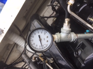

The OP pressure tested the block at 15 psi in posts 16 and 17 above. He has water in the port-side exhaust ports. I would think the water is either coming from a cracked block when at normal operating temperature and pressure, or the water is coming from a cracked exhaust manifold. Wouldn't a pressure test of the port manifold help to narrow down the problem?
