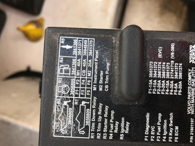

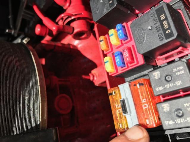

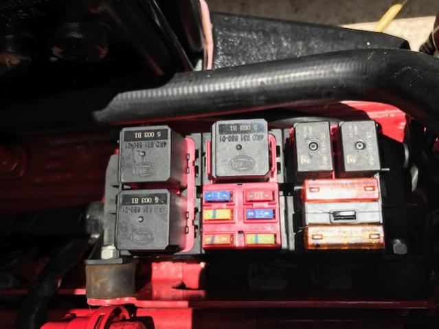

Hello all I have an issue with my volvo penta trim. Went out last wekk and when I got to landing trim not working up or down no clicking nothing. Got the boat out of the water ran jump wires to trim motor direct could get up and down. got home did research and was told sounded like relays. So purchased relays on pump replaced both still nothing. then was told to look for 10amp fuse on pump and check found brand not blown. found fuse block on top of engine and see there is 2 more relays for trim up and trim down there also saw what is listed as CB by schmatic Circuit breaker for trim pump I assume. the button on it appears to be tripped and will not allow me to push and reset. also unable to get relays or CB to remove from engine fuse block is there a special tool or a clip I dont know about because I have tried to remove all and afraid if I put any more pressure I will break or rip fuse block from engine. Please help I am new to this and want to learn
