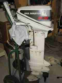

Johnson Sailmaster 9.9 - help to identify year/model
John DeLong
I have a Johnson Sailmaster 9.9 - the block is stamped 336160-2 D-1 just above the port lwr aft engine mount, and the freeze plug is stamped G2648482. The throttle handle has a kill switch at about the middle which I learned dates it between 1991 and 2007.
Thanks for any assistance!
No not at all.-----That style of cowling on the 9.9 / 15 HP was last marketed in 1992.-----1993 to 2007 was totally different !----I say that motor is a 1992 model.
