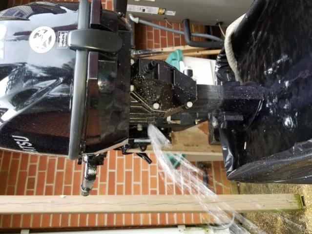

I removed the apron from the lower unit, started the motor, and took the attached photo of water discharging from the motor. (I'm not sure what that hole is called from which the water is discharging.) While it seems to be pumping fine, no water came out of the pee hole, but I could feel puffs of air coming out. After running for a couple minutes the motor was hot to touch, so I cut it off for fear of overheating. Still seems like there is some kind of obstruction somewhere, but it is definitely not the pee hole or the hose that feeds the pee hole.

If you are getting puffs out of the pee hole, you are not pumping properly. Review the water pump installation again. If the water pipe is not seated correctly, your pump will fill the exhaust housing, but not pump up into the power head. You can check for 150F on the power head with an IR thermometer.

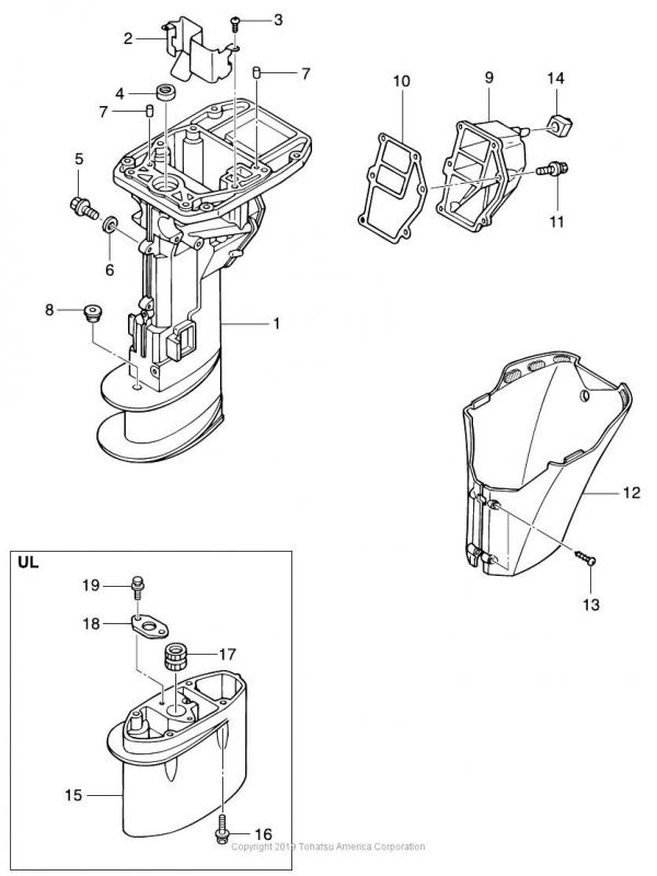

The "air" that is coming out is actually exhaust. All that water coming out of the side drain looks like the pump is not connected to the water tube. Is the grommet in the water pump housing for the water pipe to seat into? If not, you are just pumping into the exhaust housing... not up into the power head.
Removed lower unit. Grommet is in place and pipe seems to fit perfectly when upper end of drive shaft seats in place. I tried a little experiment doing a reverse flush: 1) Removed pee hole hose from where it attaches to exhaust cover. 2) Attached to the exhaust cover a piece of tubing of same diameter and adapted the other end of the tubing to connect to garden hose. 3) Turned on hose and water exited exhaust housing and water pipe that had been disconnected from impeller housing. 4) Removed thermostat housing and saw that water was making its way to the thermostat housing. 5) Since water seemed to flow everywhere it was supposed to (albeit, in a backward direction), I figured there could be no obstruction in the entire system. 6) Put everything back together and ran it in the tank. 7) Head quickly reached 200-plus degrees, and no water coming out the pee hole. 8) Any ideas on how this could be??

Took everything apart again and verified that assembly matched what is shown on the parts diagram. Checked that key is in place and turned drive shaft to verify that impeller turns as shaft turns. Put everything back together and started it up. Water comes out of side drain but, once again, nothing from pee hole, and head overheats. I've never been more discouraged about anything. I keep thinking it must be something simple, staring me in the face. I think back to when this started: operating the engine for 20 minutes without the flush plug in place. When I replaced the flush plug I hoped it would start pumping again, but it didn't, and I started down this path of replacing water pump parts.

Sorry for the mistaken reference. The hole I'm referring to is shown in the photo I posted in #5. As I indicated earlier, I wasn't sure what it was called. It doesn't seem to have a label in any of the illustrations. You have since referred to it as the "side drain."
