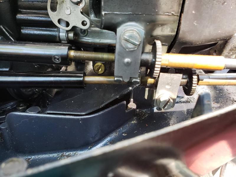

    The black plastic wheel on the throttle cable needs to be adjusted so thatt the arm is ppulled against the idle stop screw.----May need to adjust idle stop screw as well.

    Adjust the wee black plastic wheel on the cable !!----That will help you solve this .----Nothing to it .

    I will upload a picture. I assume this is the black wheel you are talking about? The bottom one? Also I put another video on my youtube which is linked here which shows a little better what is happening and what I am talking about.Click image for larger version.
ID:	20096. I do appreciate everyone's help and apologies for being so bothersome., https://youtu.be/QlPJ61QO7R4
