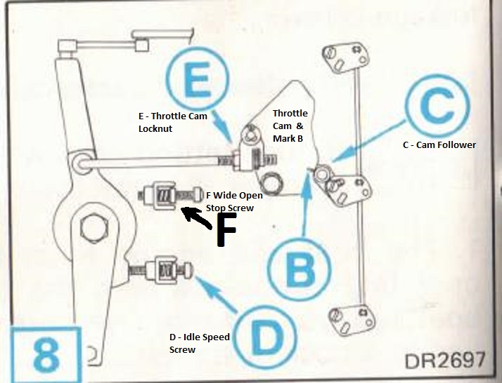

I'm trying to finish my friend's 1990 70hp 3 cylinder so he can sell the boat, and I have run into a problem with the Idle Speed and Synch and Link adjustments, here it is:
On the water, I had to set the idle speed at the maximum the idle speed adjustment screw would go in, in order to get the RPMs the engine needed to not keep turning off at idle when starting in cold. To be more detailed, every time when I would turn off the engine to fish for say 15 minutes, I would have to rev it up, accelerating in neutral to get the engine to start, it would not start at the idle speed. With the idle adjustment screw all the way, it worked better, but still not really good like I've experienced in the other engines that I have had or worked on in the last 7 years. Those engines in the same situation, turned on just by touching the key without any acceleration in neutral, just in idle speed.
After I set the Idle Speed Screw to the maximum, the engine idle speed in neutral was 1275 to 1300+ rpm on my hand held tach, but in gear it was around 800+, which worked fine. Later when I went to set the Throttle Cam Mark (B) to the Cam Follower (C) they would not align until I set the Throttle Cam Locknut (E) to the maximum it would screw into the left. Then in order to get the Wide Open Throttle, I had to set the Wide Open Stop Screw (F) all the way out so the stop was actually the body of the engine, not the screw. In other words, In order to get the Cam Mark to align, I had to set the Idle Stop Screw to the maximum it will go in, the Wide Open Stop to the Maximum it will go out, and the throttle cam follower screw to the maximum it will go back to the left, everything is maxed out!
I had previously set the carburetor idle mixture needles at one turn out, which improved the rpms. I had adjusted the carb throttle plate. The engine runs great at high speed.
What could cause the idle to have to be set the maximum, and really still not work right? Dirty carb? Electrical?
(P.S.- I had not run the engine for 2 months, and the other day when I went to turn it on, it revd at 2000 rpms in neutral and I could not get it to go down to the normal 1300, so maybe whatever is slowing it down was cleared, because the way the idle speed screw is set, it should be reving at 2000. Yesterday when I went to check the problem, once again it was at 1300 rpms.)

Hopefully you haven't changed the distance between the vertical throttle arm and the cam... that would change the idle timing and through everything out of adjustment.
Do you mean loosening the locknut and adjusting the thumbscrew on the Throttle Cam? If so, I already did mess with it.

Tinkering with that nut and the distance between the vertical throttle arm and the cam has screwed up the IDLE TIMING. You'll need to reset that as oer your service manual..... spark plugs removed, timing light hooked up to the top (#1) cylinder plug wire, the idle timing (whatever your manual states) should align (flywheel mark to pointer) when the scribe mark of the cam aligns dead center with the throttle roller.

RE: Tinkering with that nut and the distance between the vertical throttle arm and the cam has screwed up the IDLE TIMING. You'll need to reset that as oer your service manual..... spark plugs removed, timing light hooked up to the top (#1) cylinder plug wire, the idle timing (whatever your manual states) should align (flywheel mark to pointer) when the scribe mark of the cam aligns dead center with the throttle roller.

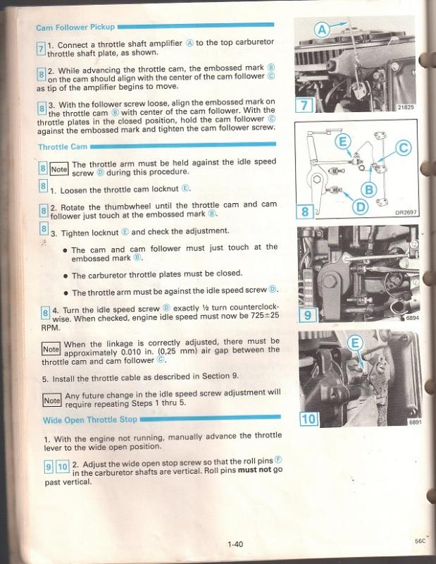

In the Synch & Link instructions for this 1990 70hp engine it says to adjust the Throttle Cam "Loosen the throttle cam locknut...rotate the thumb wheel until the throttle cam and the cam follower just touch". Maybe you mean I adjusted it too far, like 3/8" of thread?

The synchronization/Link thing..... what the book is telling you is that when the scribe mark of the cam is dead center with the roller.... the idle timing listed in the manual should register on the flywheel (timing light). And if it doesn't, the distance between the vertical throttle arm and the cam has to be adjusted one way or the other.
The roller itself should be approximately 3/8" in diameter..... If it is only something like 1/8", the outer covering has broken away. In which case replace the roller.

Re: The synchronization/Link thing..... what the book is telling you is that when the scribe mark of the cam is dead center with the roller.... the idle timing listed in the manual should register on the flywheel (timing light). And if it doesn't, the distance between the vertical throttle arm and the cam has to be adjusted one way or the other.
[Do you mean - what the book is telling me is that when the scribe mark of the cam is dead center with the roller.... the engine idle speed RPM's listed in the manual (it says 725+- 25 rpm) should register on the flywheel (using a hand held tachometer). And if it doesn't, the distance between the vertical throttle arm and the cam has to be adjusted one way or the other?]
Re: The roller itself should be approximately 3/8" in diameter..... If it is only something like 1/8", the outer covering has broken away. In which case replace the roller.
(the roller looks good is not warn where it slides on the Throttle Cam, or anywhere)

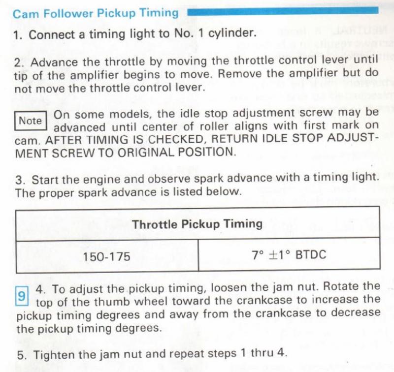

You are not looking for any specific rpm, nor will what you are looking for be found with a tachometer. You need to use a timing light to find the Idle Timing Mark which is normally quite low... something like 2,3, or 4 degrees.
Nowhere can I find anything in the manual that mentions the timing mark degrees with a light.
Nowhere can I find anything in the manual for my 1990 Evinrude 70hp 3 cylinder that mentions the timing mark degrees required, or having to test it with a with a timing light, or that the adjusting of the Throttle Cam thumbwheel affects the engine timing.
I do find the situation explained for the 1990 Cross V 88-115hp V4 and the 150-175hp V6, in their manual, so I see what you mean, but it does not seem to apply to the 70hp 3 cylinder engine. Here is the page for the 150-175HP:
P.S.- I did now find in the manual that some of the 1990 3 cylinder engines, the ones equipped with the double mark Throttle Cam Part number 394466, do have to have the Throttle Pickup adjusted to 1 degree BTDC, just like Joe Reeves described. For those engines you use the Section titled Method "A" Synch and Link Adjustments, which is different from mine.
My engine has a single mark
Throttle Cam Part number 431707 and uses Method "B" Synch and Link Adjustments, which has no section at all which mentions the Throttle Pickup adjustment to X degree. My model does not need it.
How does your book explain how to adjust that thumb wheel/lock nut to obtain the correct distance between the vertical throttle arm and the cam?
