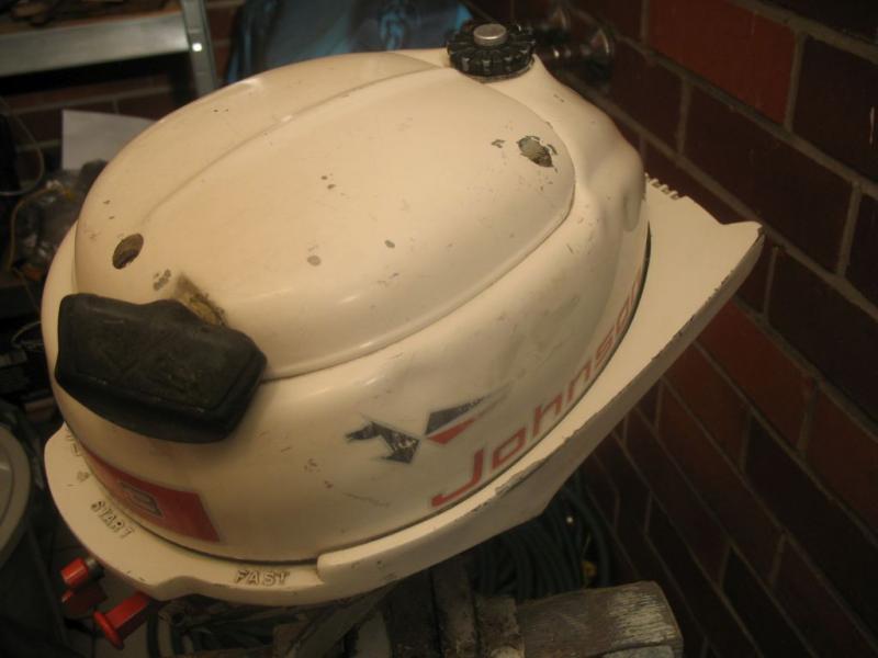

I got Evinrude 3hp, 1966, for free and now i am planing to do complete rebuild for the engine. I have already done one rebuild for one Mercury engine, so the work itself is not new to me. Also this Evinrude, seems very simple engine. Also i am going to paint the whole engine again during the work.

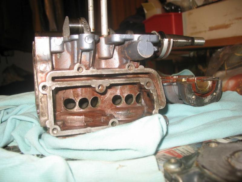

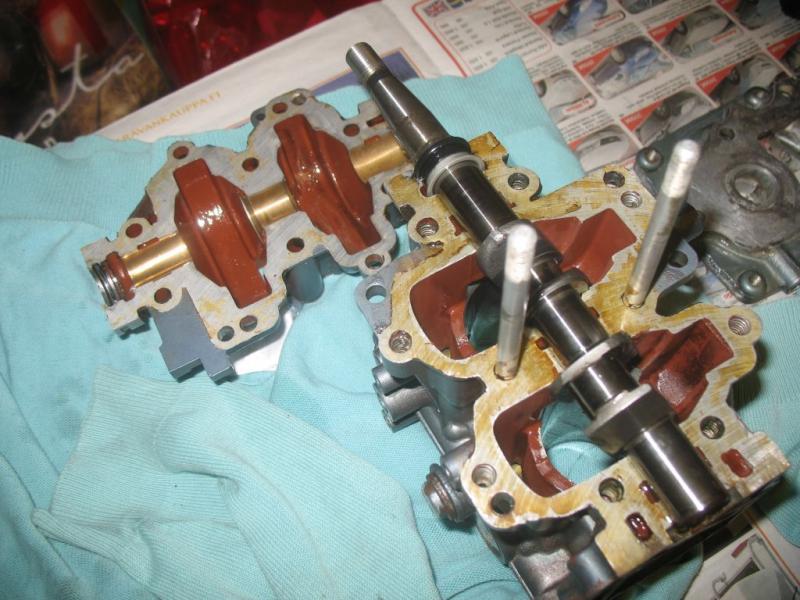

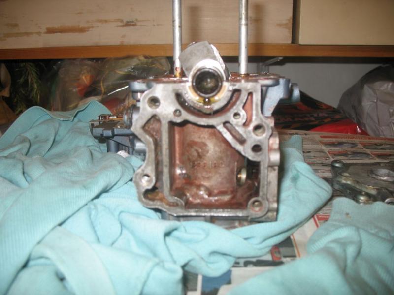

Anyway right now the situation is: before my ownership the engine was overheated and seized. I got the pistons moving by putting lot of oil to the cylinders and let it be overnight. After that i started the engine. It runs very smooth, and really feels okay without too much smoke. My test drive took about 1 hour, then i put engine to the boat and begin my short trip. Everything was fine until i give it little bit more gas. Nothing was happen, engine only runs about half speed, even throttle was about 70% setting. Engine only run half and under, speeds. It does not take more revs. But there is no any unusual sounds, only smooth engine sound. So, today i took of exhaust-plate cover and looked about piston rings, upper cylinder one ring is not good, all others rings are good. One piston have scored marks on side. After took of cylinder head, i saw very shiny cylinders without scoring, but cylinders really need to be hone. Anyway, there are no anymore new pistons to available to this engine. My question is: If i buy new pistons,connecting rods,pins that are for 1982 4.5HP engine, do you think it will work? I know there is different bearings in the rods, but bore/stroke is same in that 1982 4.5HP engine. It would be nice to hear what others think about my idea?
Of course my rebuild will include: Hone, complete cleaning, new washers,new impeller,new reeds,rings, carburettor cleaning. I just really want to save this nice engine. Thank you
