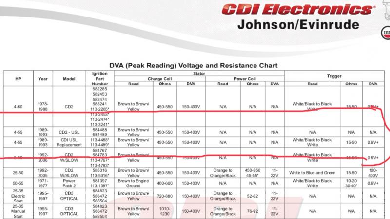

The electric start is nice but, yes, the motor has to work otherwise the starter means nothing. I have gone to CSIelectronics.com but haven’t found the right page to help. There is no spark. I have tested the coils with a volt/ ohm meter but didn’t know what I was looking for. Amphenol connectors, I’ll have to look that up to know what that is.

Partee217.... At some point in all the above, you mentioned replacing the powerpack and also mentioned low voltage being supplied to the coils. That indicates, usually, a failed or failing "Charge Coil" that supplies the needed voltage to the powerpack capacitor.
The ignition and electronic unit under the flywheel of that model normally consists of the "Powerpack", "Timing Sensor", Charge Coil", and a "Two Coil Stator".... If your unit is different, let me know.
Now... Disconnect the battery before doing any of the following. One sparking event would be expensive!
If memory serves me right, read on:
The "Timing Sensor"... The ohm reading between the disconnected two wires of the "Timing Sensor" on the "Low Ohms" scale would be 40 ohms +/- 10 ohms..... then using the "High Ohms" scale, check for shorts between either wire to ground. What did you get?
The "Charge Coil"... If electric start equipped direct from the factory, the ohm meter set to "High Ohms", the reading between the two disconnected wires of the Charge Coil would be 475 ohms +/- 75 ohms.
If equipped with only "Rope Start" from the factory with the electric start installed at a later date... the reading would be 575 ohms +/- 75 ohms. In either case (rope/electric) check those two wires for shorts between the coil and ground.
However... if that black charge coil is melting down... has a sticky looking substance dripping from it, replace it regardless of what reading you might get as that would result in a voltage drop to the powerpack. Let me know what you found with this charge coil.
Note that a slow cranking engine would result in the flywheel magnets moving at a slow rpm past that charge coil which would result in weak, erratic, or no ignition. I don't recall if that info is listed in the service manuals or not but the average rpm stated is normally around 300 rpm which is always exceeded in yanking the rope thru or acquired via the electric start system.
