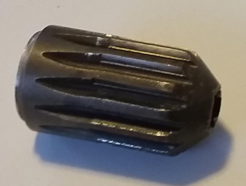

Drained oil from leg 250ml,pulled top cover,gears stripped blue in colour,oil doesn’t evaporate,no leaks,wasn’t filled when water pump done,have discussion with pump repairer tomorrow.

Was this the first trip with the boat after the water pump was serviced? If "yes" then the oil was not filled, if "no" chances may be that you have a leak. Did you pressure test the drive?
