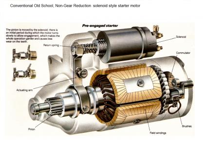

As the S circuit is energized, the electro-magnetic coil becomes energized. You will see a load while energize.
As the coil becomes energized, it pulls the plunger.
The plunger (via internal actuator arm) kicks the pinion gear into the flywheel ring gear as it simultaneously closes the main armature contacts.
Once the main contacts close, the armature should spin........ but only if the main Positive battery cable is connected correctly, and only if the starter motor chassis has a good System Negative Common connection.
Here's an old School Non-gear reduction solenoid style starter motor.
(pinion gear is 1 to 1 with armature)
