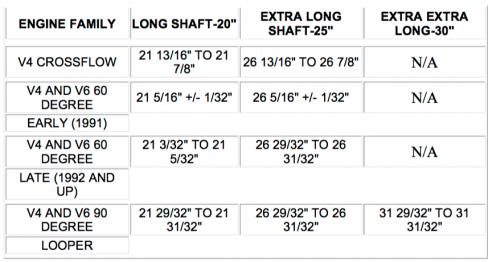

I don't want to jump to conclusions and say you also have the wrong shift rod, but the symptoms are similar. I don't have any manuals to reference, but this chart I found shows your shift rod height should be 26 29/32" (683.25mm).
If that's true, your problem could simply be an improper adjustment. The rod moves down for reverse and if you have it too short it will easily pull up for forward but won't quite reach low enough to fully engage the clutch dog for reverse.

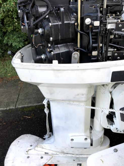

Now, with the linkage centered in neutral, hold the shift cable into place and thread the adjuster in or out until the mounting locations line up with the retainer bracket (the one you pictured) and the mounting pin on the linkage. If this all works out right, you should have clean shifting between F-N-R.
