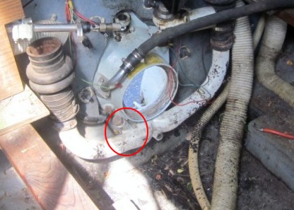

I think I posted an image of inside transom before. Let's see ... yes here it is. This was with the exhaust Y-tube that came with 360 engine that I elected to not use because the exhaust bypass is plugged and because, as you can see, it definitely does not allow for clearance of the steering knuckle which is in view at upper left. The white part is the socket for ball joint that's attached to transom.

Apparently the flapper in bellows has replaced flapper on exhaust port. At least that's what the parts suppliers told me. Too bad as I think the exhaust port flapper makes a lot more sense. You can see when it's broken. The one in bellows falls apart and can get stuck.
Yes, that is the interior of your Transom Shield!
There are several things wrong with this set up for a 360 cu in engine.
1..... that small Y-pipe is going to hinder performance.
2..... without the low-pressure-relief connected to the exhaust elbows, your engine may "load up" up low speeds.

The 280, 285 or 275 transom shield, along with the 95mm Y-pipe would certainly make things easier and better for you.
For the 4 cylinder engines this is OK, but NOT for a V-8. Too restrictive!
