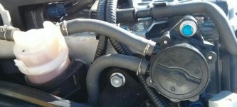

Check to see if you have the updated fuel pump. If you look at the hose from the fuel filter to the fuel pump, does the hose go to the upper pump nipple or lower pump nipple. If it goes to the lower nipple, you have the updated pump.
Do you have an external water separating fuel filter? Be sure that all is well there and the nipples and pipe plugs are sealed and tight.
If you do not have the updated pump but have an external water separating fuel filter, you can do a small test that will help you determine if the pump is really the problem. Get a 5/16" barb'd double nipple and bypass the fuel filter on the engine. Disconnect the fuel filter on the top of the engine completely and connect the two hoses together with the double barb'd fitting. We used this as a fix for the faulty fuel pump while waiting for Honda to come up with a new pump solution. This was only on early models like yours.
