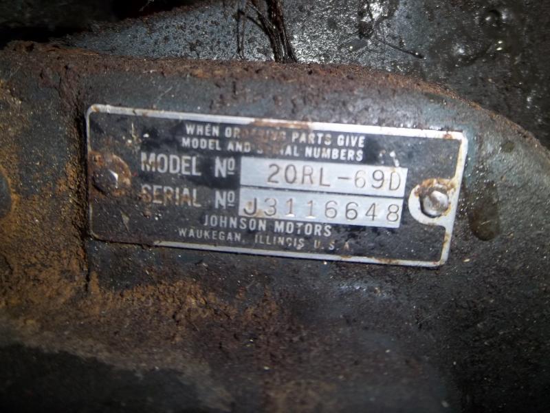

I was given an old Johnson 20 hp electric start outboard and with a little tinkering I got it running. It didn't have any water coming out a pee hole anywhere, so I got a new impeller for it as well as it needed a new starter solenoid. I replaced both of them and fired it up and still no water. I'm not sure where the pee hole is suppose to be on this, as it doesn't have an obvious hole anywhere that it comes out. Anybody know anything about these? Tnx for any help.
