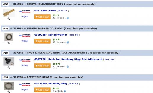

    I have a 1982 15HP Evinrude, I am replacing a broken Idle knob and screw. What is a good starting point for adjustment. Not sure how far out i need to screw it in.
    Thank you

    That is the idle SPEED adjustment.----Not a mixture adjustment.----Set it where you are happy with the trolling speed you like or set it so it does not stall when motor is put into forward

    Go to leeroys ramblings he has lots of good infor for your motor. If you know a good machinist you can rework the idle control knob to work better or just buy a new one if you can find one. They do wear out quite common!
