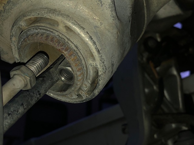

This is what I found this morning... the NE corner of the pic is going toward the top front of the motor and the SW corner is going down toward the prop. This is looking from underneath where we can clearly see the upper shift rod is detached from the lower shift rod, just like you said:
(Sorry for the small pics... I don't know if this site limits the size of pictures we can post, but these were normal size when I uploaded them.)
A couple of minutes later, I had the rods realigned and the nuts snugged down:

I followed the instructions above and wanted to report back on my experience. I started with positioning the jamb nut 8mm from the top of the lower gear shift bar and tightened the longer nut down onto the jamb nut. (NOTE: Definitely rotate the prop and put the shifter in reverse so the shift bars move downward, exposing those two nuts. Otherwise, it's basically impossible to get a wrench on the top nut.)
This left some grinding (strangely, in both forward and reverse, but moreso in forward). So I just kept tweaking the position of those two fasteners up and down the rod by two threads at a time and kept testing it until I got a clean "clunk" in both forward and reverse. Interestingly, the position which achieved this had the pair of fasteners pretty high up on the rod. I believe that sitting this high made it easier for vibrations over time to make the two come apart, which caused the problem. This is a 2000 model motor and gets used often.
One final question: would it be okay to put some loctite on these to help prevent them from coming loose? Do I need to do anything more substantial? I will, of course, make sure I check the tightness of those fasteners as part of my monthly standard maintenance going forward.
