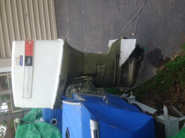

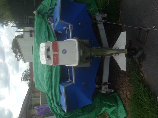

Hi,
Please see pics attached i have tried to motor at a couple of different levels with the holes available but dont think this would stop it moving in the water?IMG_0328.jpgIMG_0327.JPGIMG_0326.jpg
That prop looks like it has been grinding the riverbed for some time. If it shifts into forward and reverse you should hear it shift. Trim the motor so the fin is level with the keel. Have you pulled the lower unit? I’m leaning toward stripped splines on the driveshaft or crank do you know how old the impeller is?
yeah the prop has a few knicks on it. When i do shift from forward to reverse it is very quiet but i can see the prop change direction quite quickly. Yeah i have pulled the lower unit and the splines on the driveshaft looked fine. Not too sure how old the impeller in the water pump is but it pumps plenty of water in a tub thru all the tell tales.
Yeah very confusing.
I appreciate your efforts, but you simply are not giving us the information we need. I want to see a picture that shows the height of the cavitation plate in relation to the bottom of the boat. If nothing else, at least hunker down behind the boat and take a shot at cavitation plate level, toward the boat. The first and third pictures you did show seems to show the plate way above the bottom. But it could be just the camera angle.
If it is too high, those mechanics you have been consulting should notice it right away. It won't push the boat if the prop is not in the water.
