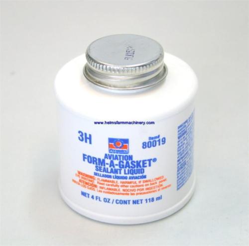

    What about PERMATEX Aviation Form-A-Gasket Sealant? It comes in a can that has a small brush in its screw off cap:

    No doubt the same substance as the gasket sealer in a can with a brush attached to its screw on/off cap as I mentioned.
    I'll revise my info on that in my database.
    The permatex I spoke of pertained to the super heavy substance that comes in a tube and dates back to the Ford "Model T"..... In thinking about that, so do I.

    If they do not have the coating, I do use that Permatex Aviation Form-a-Gasket liquid. I've used it on the Johnson Evinrude head cover gaskets on my early 90's 25's and 115, and Yamaha 115.
