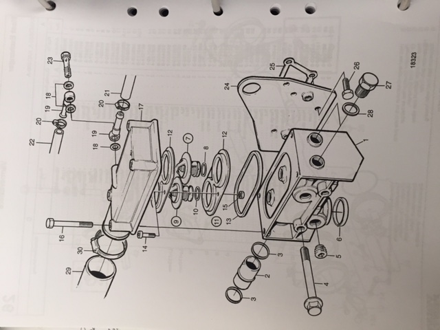

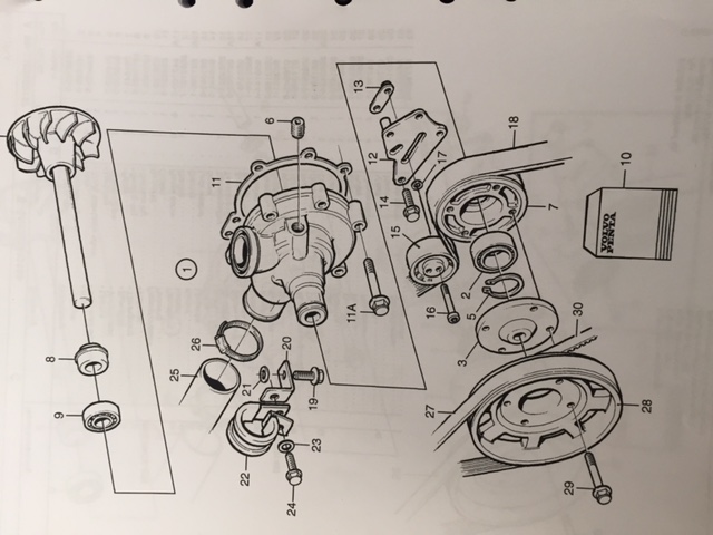

    OK, i have the pump rebuilt and having real problems getting the seal between the thermostat housing and the pump. I have enclosed a breakdown of the water pump and will be sending a breakdown of the thermostat housing so you know which seal Im talking about. When you are trying to line up the pump its impossible to get the seal to fit properly between the housings. Once you think you have it you can see an area when the seal is folded in and not sitting right. Please help I'm going crazy with this. The seal is #6 in the thermostat housing breakdown and in the other breakdown of the pump you can see where it goes. Its like a wedge fit you can't lines the bolt holes up with the seal in place and when you try and install one bolt in on the left top on the pump you can't get the seal in properly.

    Thanks for your reply Aliboy, i was going to try and put a little grease around the seating surfaces and maybe that would aid in the correct position. The problem is that you cannot see the back part of the seal to see if it is entirely fitted. Also you cannot drop the pump down even half an inch to allow the seal to release from the part where its hanging up. Do you think its out of the question to remove the thermostat housing first, install the pump, then install the stat housing on top? I only see two bolts holding it from the front of the engine. Is it fastened to the engine on either side? And is there a gasket between the thermostat housing and the engine? Need direction?
