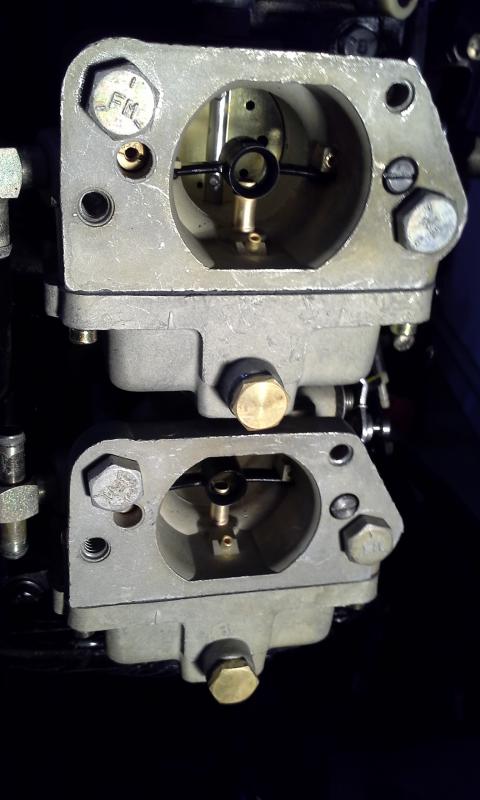

hey All,
new to this site,
A friend gave me this 1986, 60hp, 3-cyc, Mercury.
I'm trying to revive it, and have it running, jus not well yet.
Compression 140 ish on all cylinders cold, new stator since wires were broken, new trigger this week, good spark, new plugs, fuel lines new and fuel pump works.
Rebuilt carbs with complete kit. When testing at boat ramp, the top carb of the 2 has visible fuel going thrugh the venturi, but the bottom carb doe not.
could this be a reed valve problem, or I need to check that carb again?
thanks,
