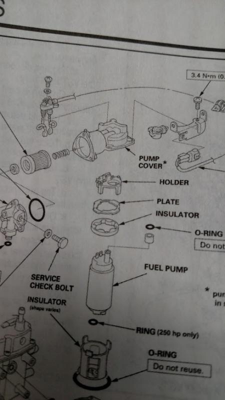

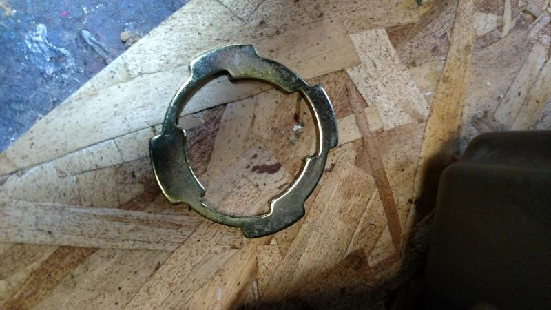

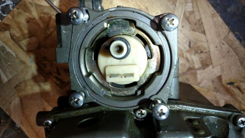

    The one part I am not sure how it goes back together and it may not matter is the plate on top of the fuel filter, it fell out of its place before I had a chance to get a pic of it, my SELOC manual doesnt say if it goes any certain direction, but it has 4 outer ears and 3 inner openings. Depending on which direction I rotate it, the openings are in different spots on top of the fuel pump.
    Does it matter which direction the plate goes?

    Plate in one possible orientation

    From SELOC manual

    It looks like you have it correct. The Helm Manual does not mention a specific line up - just that the electrical terminals need to line up correctly. Page 5-90.
    Be VERY careful about depending on that Seloc manual. Lots of errors and omissions.
