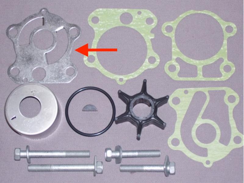

    Pictured below is the water pump kit for your motor, 2003 90TLRB. I've got a red arrow pointing at the base plate. It is possible that when you installed this kit the base plate was installed upside down? The housing would still be able to be screwed down with the 4 bolts because their holes would still line up with the housing bolt holes, so to would the crankshaft hole. But if this plate was upside down, the cut-out water inlet grooves would deflect water instead of allowing water to run through. But at idle when crankshaft is at its lowest rpms, I could see the pump being able to pull in enough water to push through pisser.

    Thanks for the detailed reply. Yes, I'm very familiar with the water pump and its parts as I've had it apart many times, with success in years past. I'm fairly certain the plate is in correctly as I'm careful to replace the parts as I took them apart, and use an exploded diagram as a guide. Also, I believe the plate will only line up with the cavities below when installed right side up. I've had it checked by an outboard mechanic as well. I haven't replaced the plastic housing as it is in fine shape and that was confirmed by the mechanic.
