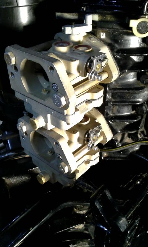

- Then checked Idle setting, Removed Throttle linkage, ALL Throttle plates CLOSED. Linkage and and adjustments will NOT let it Idle down. Moving of Trigger plate will NOT change/ Lower Idle RPM (see below). I see nothing wrong with the linkage, etc. I believe this is OK as well.

- OK Vacuum leak was early suspected as well. Visual looked OK. Nuts tight on Carbs and Reed plates. Pinched off all vacuum lines at Each ends and center of hose. No change. Still always at High Idle. Sprayed with Starting fluid on all hoses, around carbs and gaskets and best possible under flywheel (to check shaft seal). At one point I did get a reduction in RPM but I was spraying so much at the sides on the Carbs - I believe it was getting sucked in the carbs. SO I repeated this with WD40 and it did not repeat. If there is a vacuum leak it's not apparent, fairly large, and occurred very quickly.
